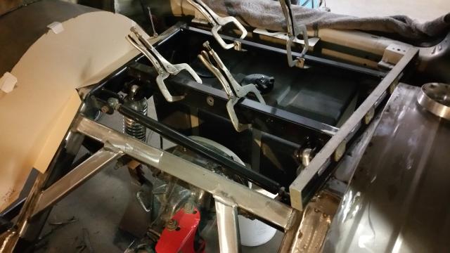

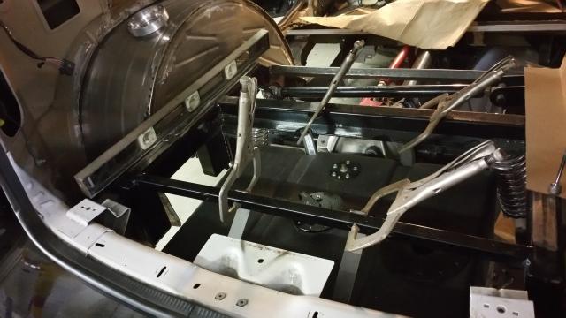

We can't go too far on the interior sheet metal or the fuel cell won't be easy to work on. Right now the fuel pump and sender are going in the tank. Once that is in the tank gets mounted and the filler neck gets installed and the filler hose and vent get run to the gas cap area. Fuel lines and sound/heat insulation will be run after the floor is complete. It's going lots of different directions right now but in a couple of weeks I hope to have it in good shape. Once all this is done we can get back on the wiring harness.

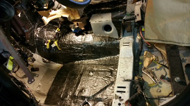

New fuel cell brackets are complete. Holes are drilled for the sending unit, fuel pump and filler neck. The floor is getting covered with heat and sound mat. I need to order more insulation mat because we're really going thru this stuff. I'm putting it on the ceiling too. I think there is going to be some serious sound/vibration to deal with.
