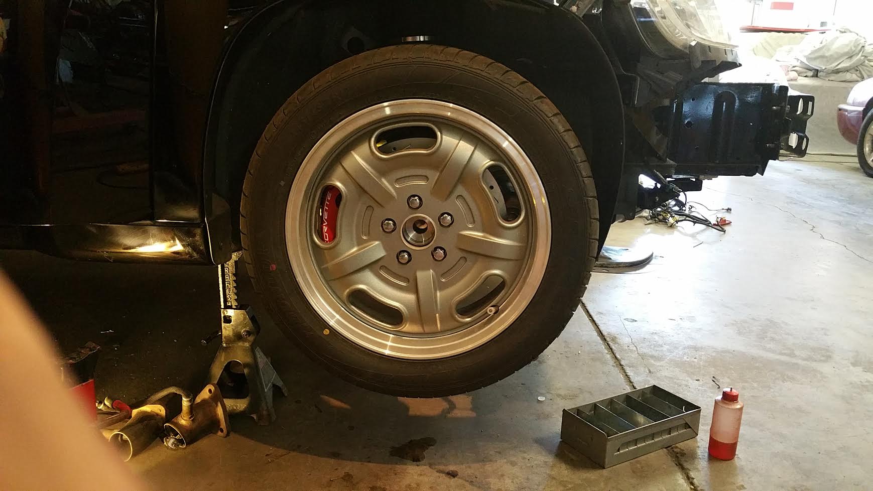

Whole Lotta Brakes For A 17" Wheel
Well the brakes are mounted and the 17" wheels are on. Their is about 1/4" of space between the calipers and the inside of the rim. Just about enough for the tire weights. Plenty of room.....

Awesome work, Cliff!! You calculated that with a close tolerance!

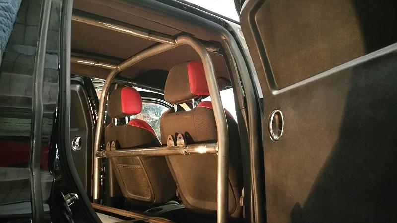

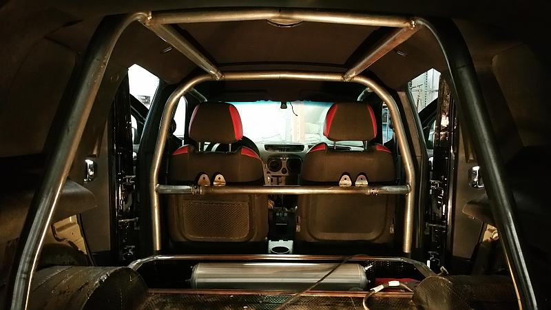

Roll Cage
The rear section ("B" Pillar aft) of the roll cage is complete. Things are changing weekly.... It has been discovered the the rear axle vertical movement due to the air bag suspension moves too far up and down to get the exhaust pipes in. Short of changing way too many things to make it fit, I have decided to exit the exhaust tips out the sides of the car. Remember all that work I did on that SS rear bumper cover making the perfect dual exhaust cut-outs? Well, it was for nothing. I am going with a Ptezer fiberglass rear bumper cover with no holes in it. Also on the list is fabricating some sheet metal rockers that are about 2 1/2" taller (lower) to encase the oval 3" exhaust tips. A friend of mine is making some handmade mufflers for the space that I have. The whole system will probably be stainless, if not mild steel that is Jet-Coated. Should look and sound really good.
Here is a shot of the rear roll cage.

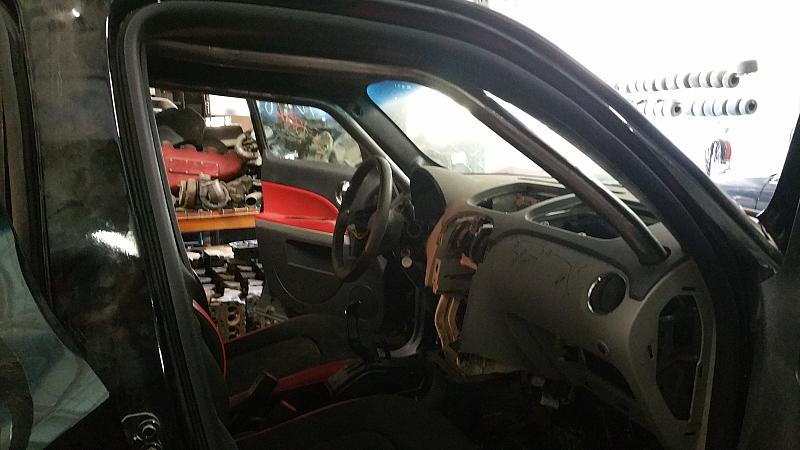

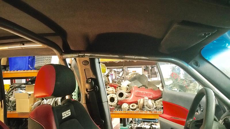

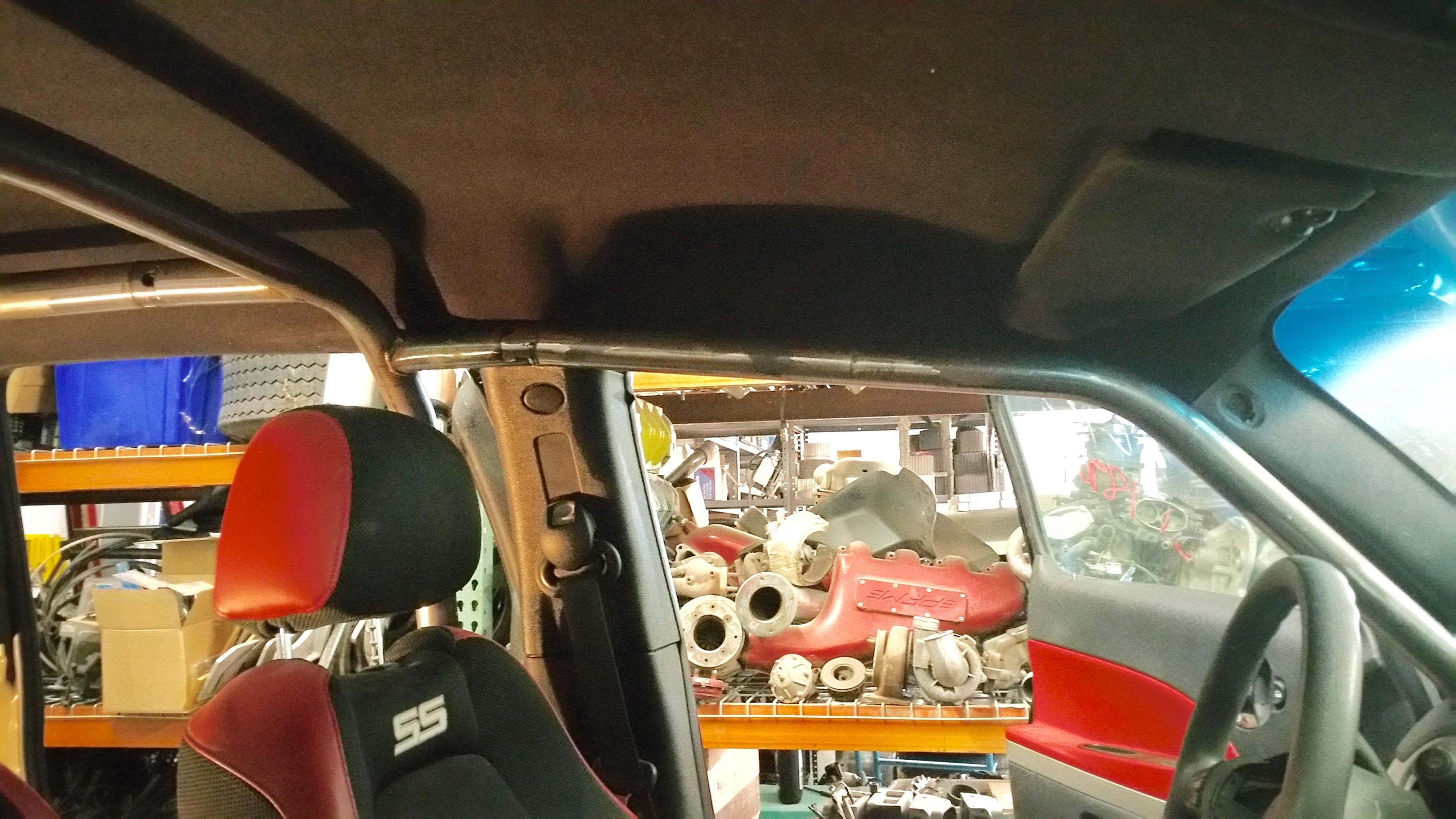

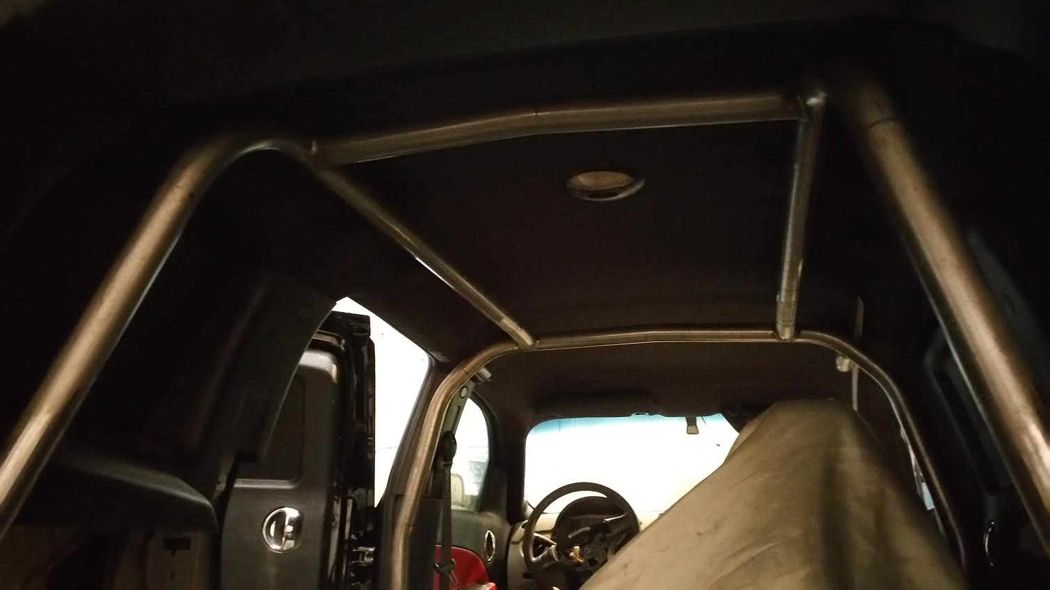

More Roll Cage Stuff
As work continues on the roll cage its getting increasingly difficult to take it out to weld and then re-install it. Just about all the pieces are done with the exception of the cross bar the goes by the windshield. This piece goes right aft of the sun visors. It will be next week 'cuse we screwed up the last piece of tubing and now I have to get more on Monday. Of course all of the tubing will be heavily padded in the front area. These tubes are safe when you are wearing a helmet but not so much on your bare noggin. The tabs are welded in for the Simpson harness that can be used in conjunction with the factory seat belts. A 4 point harness looks cool but they are NOT DOT approved and the cops know it. I'm on the jagged edge of legality now and I don't need to push it.
Attached Thumbnails V8 HHR Build-20151021_154900-3-.jpg   V8 HHR Build-20151021_154953.jpg   V8 HHR Build-20151021_154916.jpg   V8 HHR Build-20151021_155026-1-.jpg
