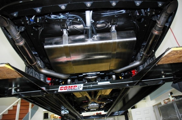

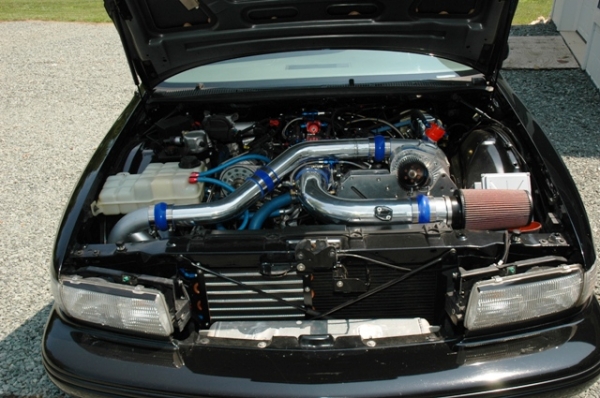

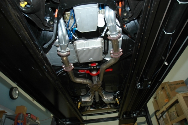

You asked.... here is my labor of love, money pit, you know what I mean. It's a 94 Impala SS, 1st year built. Did a frame off of the underneath. Tigged the frame, blasted and powder coated it. Motor is a LT1, now a 8.5CR 383, modified trick flow heads, F2 Procharger. Inter-cooler is behind the front bumper I will make some air deflectors to get air over it. Brakes are Corvette C5's.. Could go on and on but I don't want to hijack your great build thread.

Nice , no kittens huh, you know small catalytic converters?

I do have to install those to get through the visual inspection. They will go in place of the short tubes coming off the header.

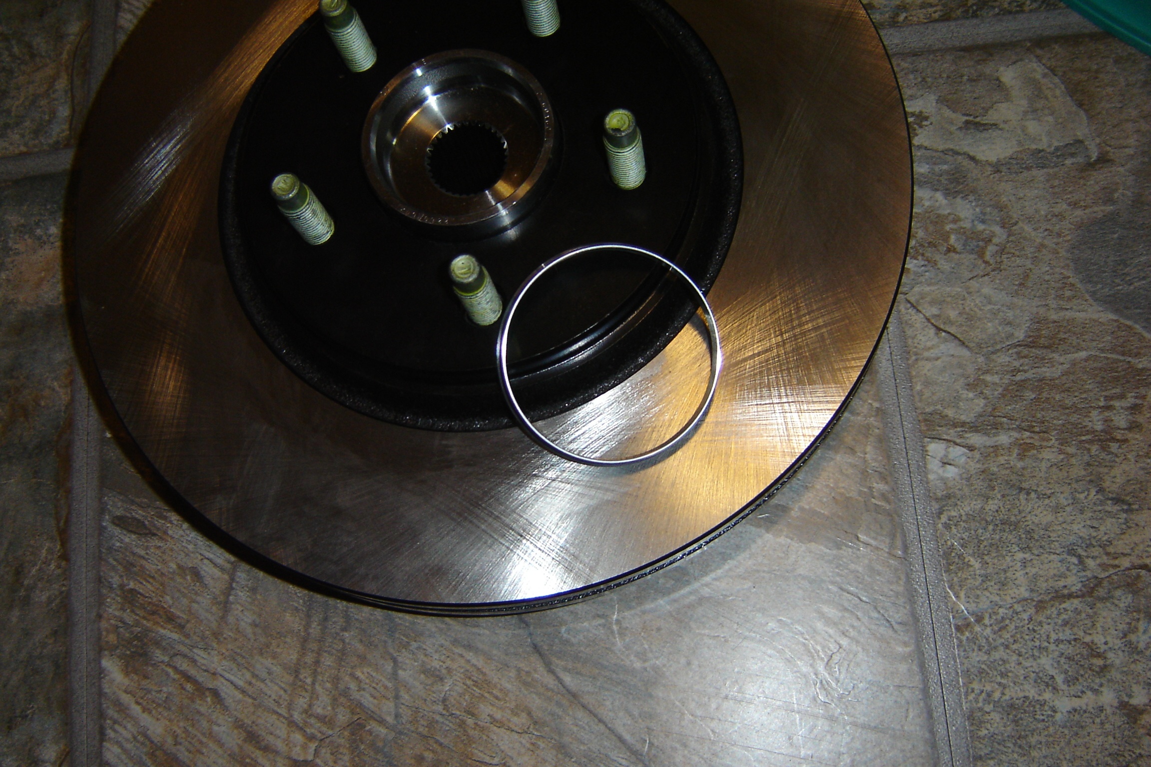

I made the caliper brackets out of 3/8" plate, got the correct length (longer) bolts, and machined a pair of concentric rings to center the rotors on the hubs. I think this might even work!
The entire secret to mounting Corvette C4 rotors to the HHR is machining rings to center the larger Corvette rotor ring on the HHR hub.
Here is the concentric ring mounted in the re-drilled 13" rotors
The 3/8" brackets and new bolts should hold the beast
This shows the alignment is spot-on without using shims.

That looks like it will work. My Impala convert is a Kore 3 and I believe the adapter bracket was 3/8 as well. Given the weight you should be good to go.
Nice work. Improvise, adapt and overcome.

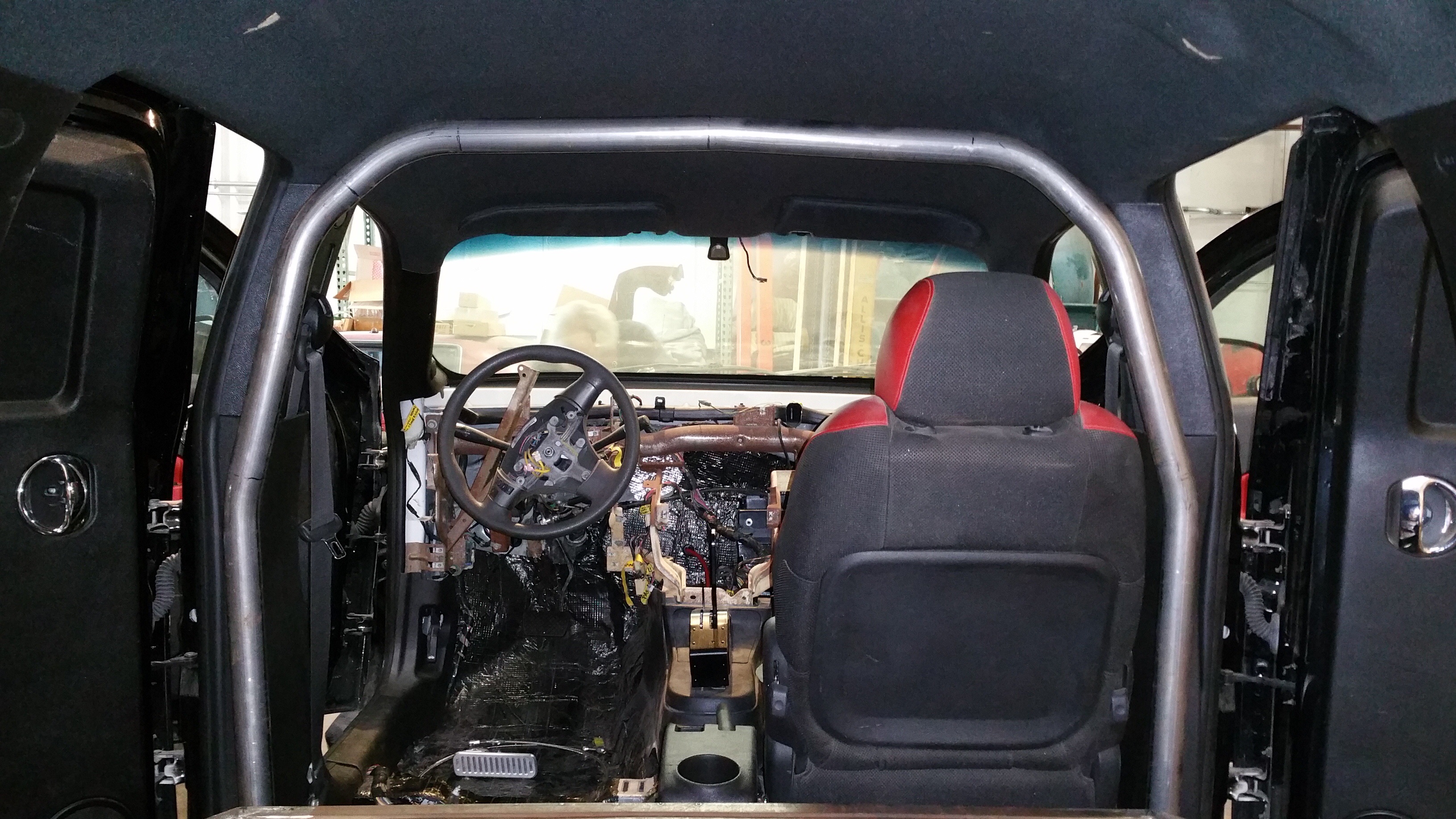

The roll cage is going in this week. The "B" hoop is in and the supports are bent and cut. The welding continues.......

You going to paint it black or upholster it ?

It's going to be satin black with black foam padding in the areas over the front windows.
