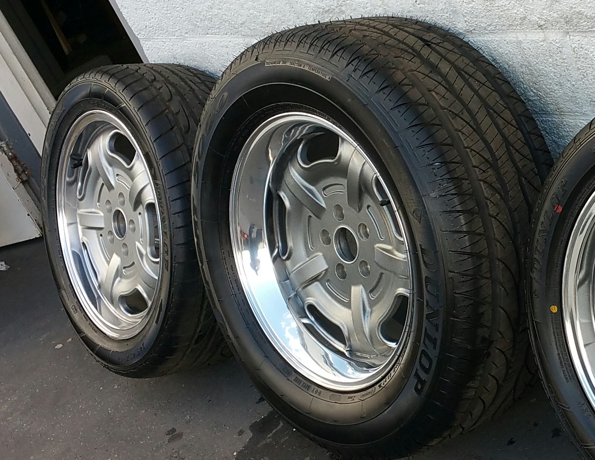

Wheels Polished
When I had the rear wheels widened almost 2" a while back they had a different finish than the original Moon SpeedMasters. To this end I dismounted the tires and sent them in to the polisher to make them all the same finish. Here is what they look like now.

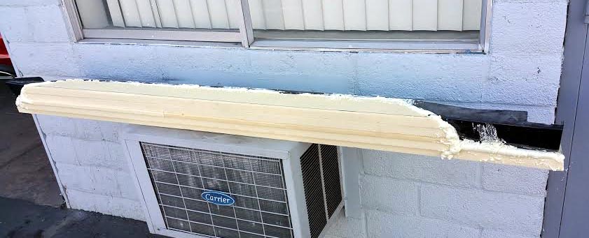

Side Exhaust Extended Rockers
I'm in the process of the exhaust system now and I need to extend the rocker panels a bit lower to encapsulate the exhaust tips. I'm taking a page from Benjiwah's build by building the rockers up with foam. I went to my local airplane supply store and purchased a sheet of 1" polyurethane foam and guled it together with 3M 77 adhesive. I then filled some gaps with Great Stuff foam. In a couple days when it is cured I will spend some quality time on the band saw to shape it. The rockers will be a little over 1" lower than the stock units giving the car a lower stance while making room for the oval exhaust tips to exit in front of the rear wheels. I'll fiberglass the outside and clean it up with Bondo. Once the shape is correct I'll take them to my fiberglass guys and have them pull molds from them. From these they will make new rockers for me. If they turn out good and if there is any interest, they may be available to forum members.

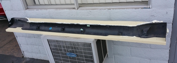

Hats Off To Benjiwah
After spending almost an entire afternoon rough shaping these rockers I am even more impressed with the work Benjiwah has done. This foam is so soft and one false move puts a big gouge in it. Plus, after you finally get one looking OK, you have to duplicate it on the other side.
Here is what I have so far. The front of the rockers are about 1" lower than stock. The rear is about 1 7/8" lower, a bit of a taper. Tomorrow i start glassing. Wish me luck.....

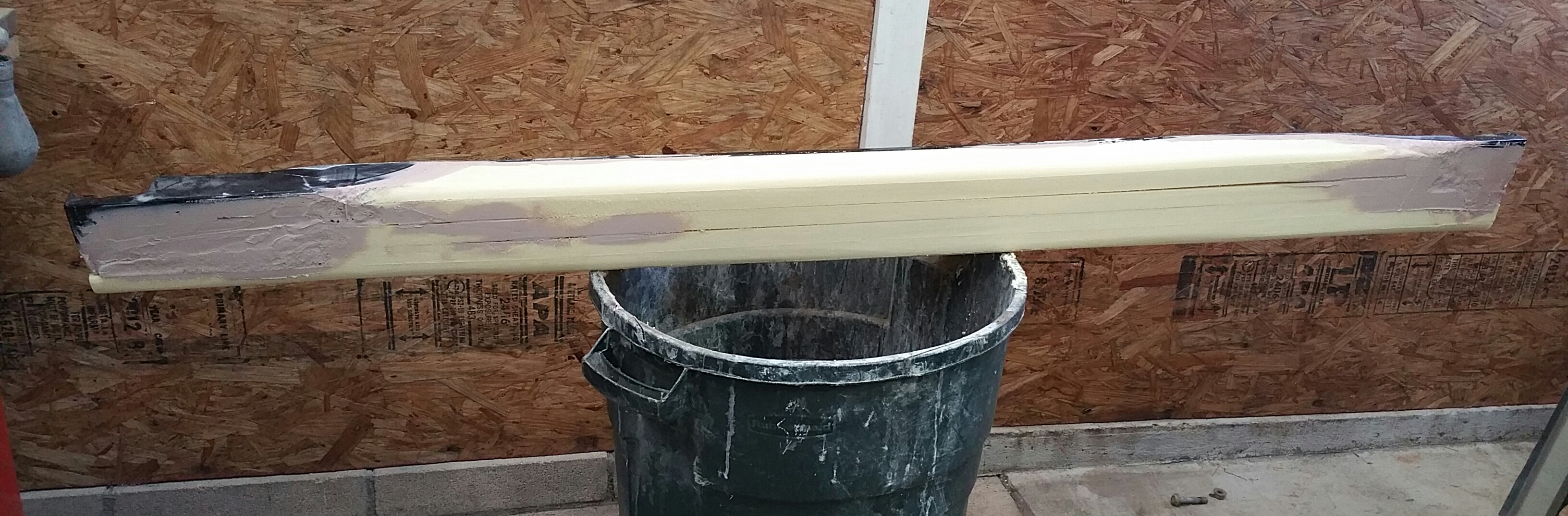

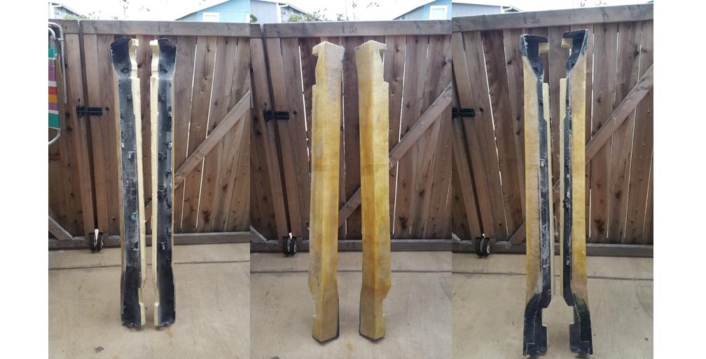

Next Step On Rockers
I was having trouble sanding the bondo next to the super soft foam so I added a layer of fiberglass mat to the entire surface. The plan is to sand the glass into shape and then add bondo to that surface. Hopefully I'll have better luck with a surface that is the same hardness. Like everything elas on this build, this is turning out to be a big deal........

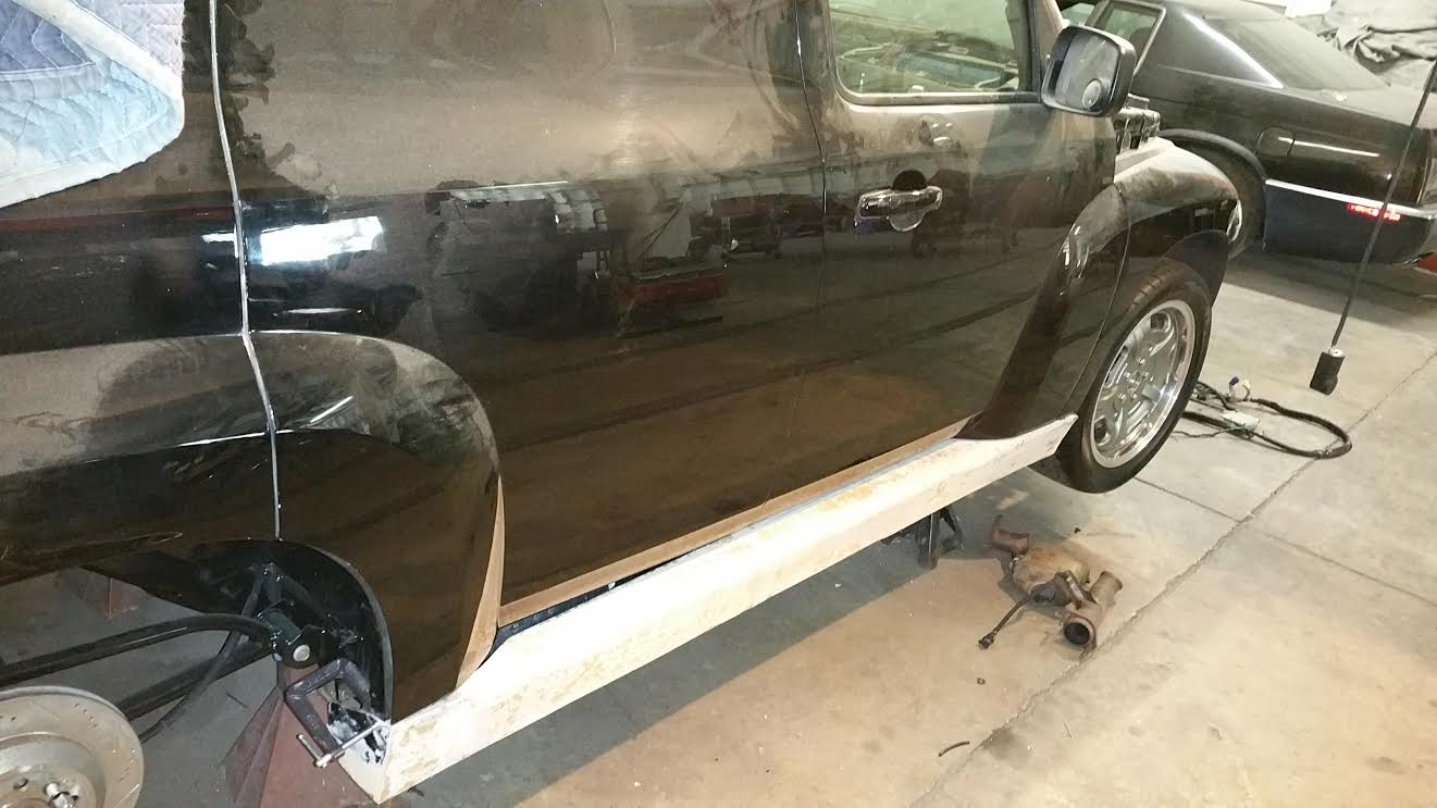

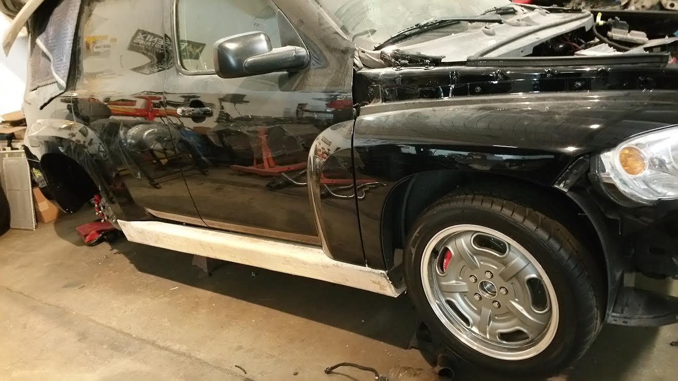

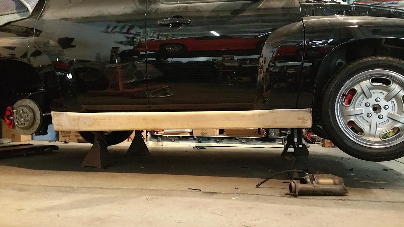

New Rockers Trial Fit
I took the rockers to the car today and clamped them in place with "C" clamps. The fit is actually better than I hoped for on this the first try. The height of the rockers is going to be just about right giving room for the 2 1/2" x 5 1/2" oval exhaust tips. One problem I need to deal with is there is a twist in the length. This wouldn't have happened if the rockers were on the car when I put the foam on them but that would have created it's own problems. Anyway, I need to add some bondo to the rear top sections to flatter them out. It doesn't matter as these are simply "plugs" to pull molds off of to make the actual parts.
