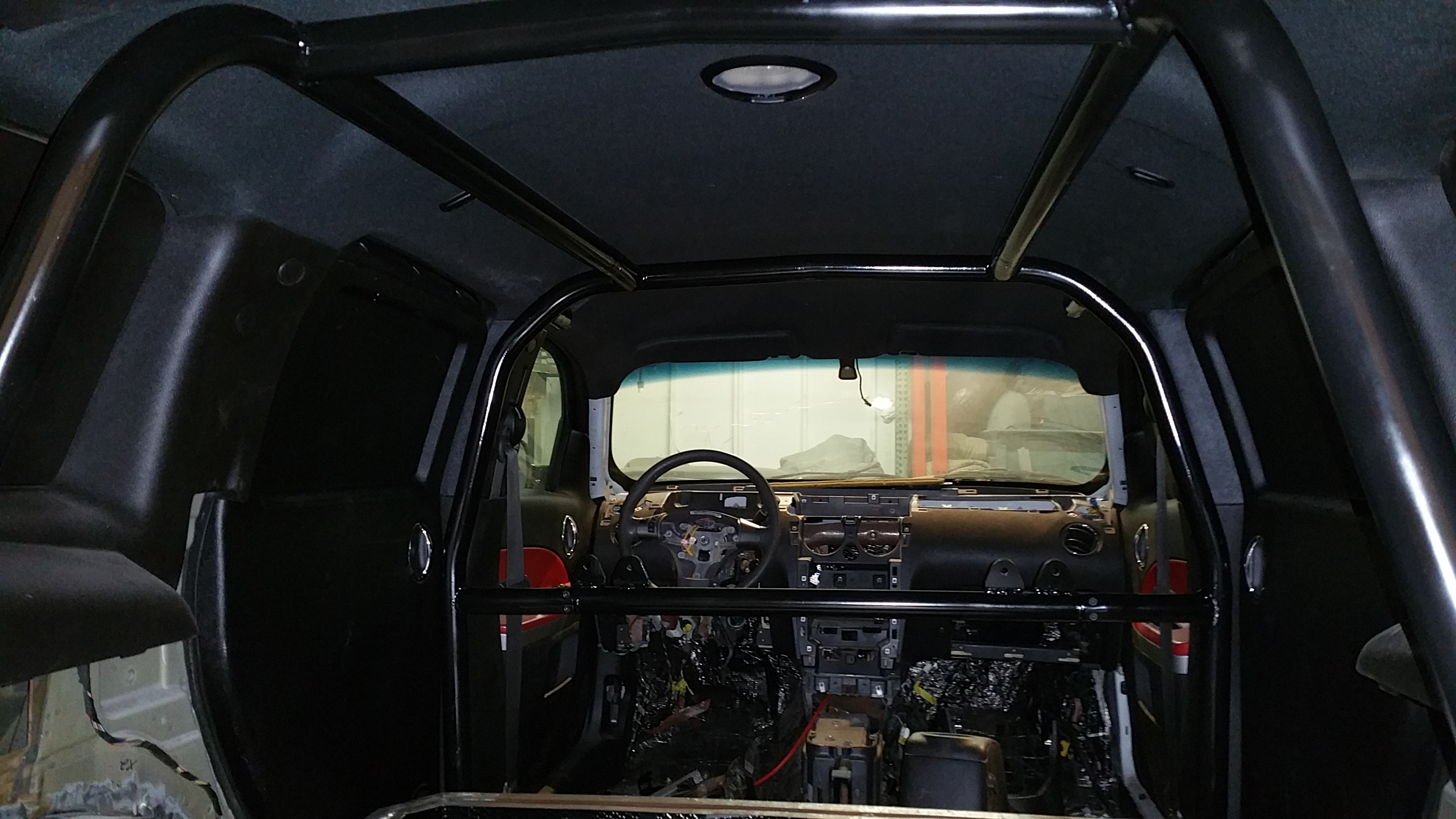

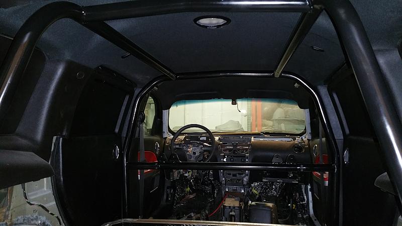

Final Roll Cage Install
Not a big deal but the roll cage has been primed and painted satin black. It has been installed for the last time (I hope) This thing is really a pain to take out and re-install.

Old Dec 19, 2015 | 08:14 PM
  #684
Posts: 40,088
Neat work!!
Old Dec 20, 2015 | 01:25 AM
  #685
Wow!

Cokeybill's Avatar
Joined: 03-28-2008
Posts: 1,115
From: Oshawa
Looks absolutely fabulous ! Great work...hope you never have to uninstall that masterpiece. Suuuhweet

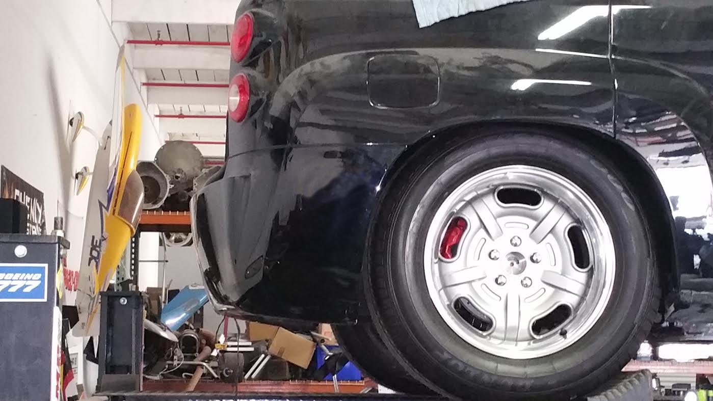

Rear Bumper
Somebody asked what the Ptezers rear bumper looks like installed. Well, here is a side shot of it. It is much shorter than a stock bumper, no exhaust holes and no marker light holes

Old Dec 21, 2015 | 02:13 PM
  #688
Posts: 40,088
Very cool!! This ride is gonna look and run fantastic!!! Are the skirts ironed yet?

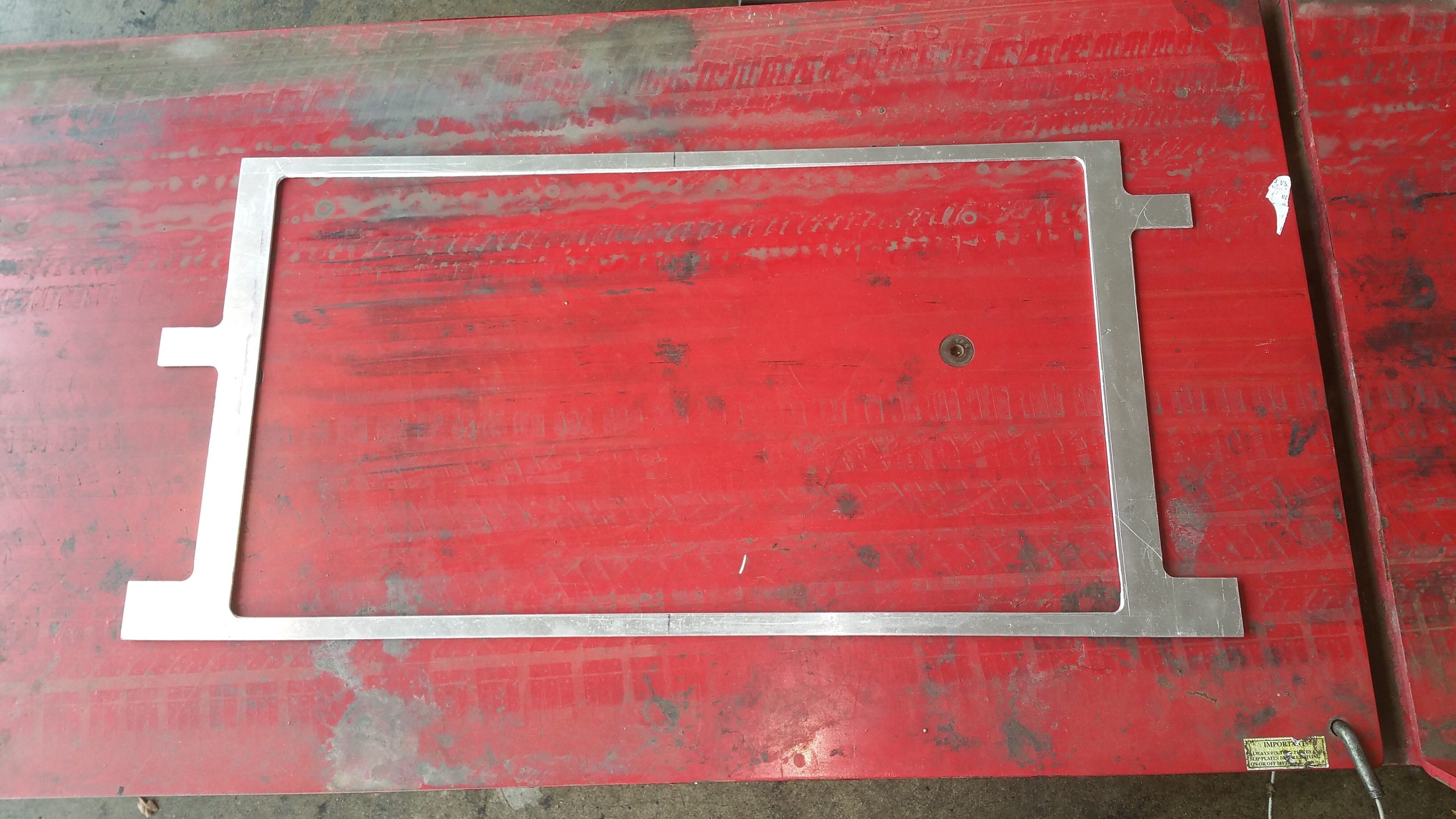

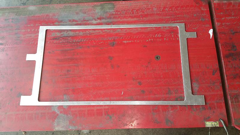

Much Ado About Nothing
It seemed like a lot of time spent on the Bridgeport and a lot of metal not used, but the a/c condenser mount is finally done. It's a piece of 3/16" aluminum plate. None of this piece will actually show but it bolts to the rear side of the condenser and slips into the brackets on the front of the Camaro radiator. This is the final piece of the a/c-heater system. Like I said, much ado about nothing..........

Old Dec 23, 2015 | 06:12 AM
  #690
Ron S's Avatar
Joined: 12-02-2010
Posts: 840
From: Roanoke Va
Sometimes the small bits are the most important, nice work.
