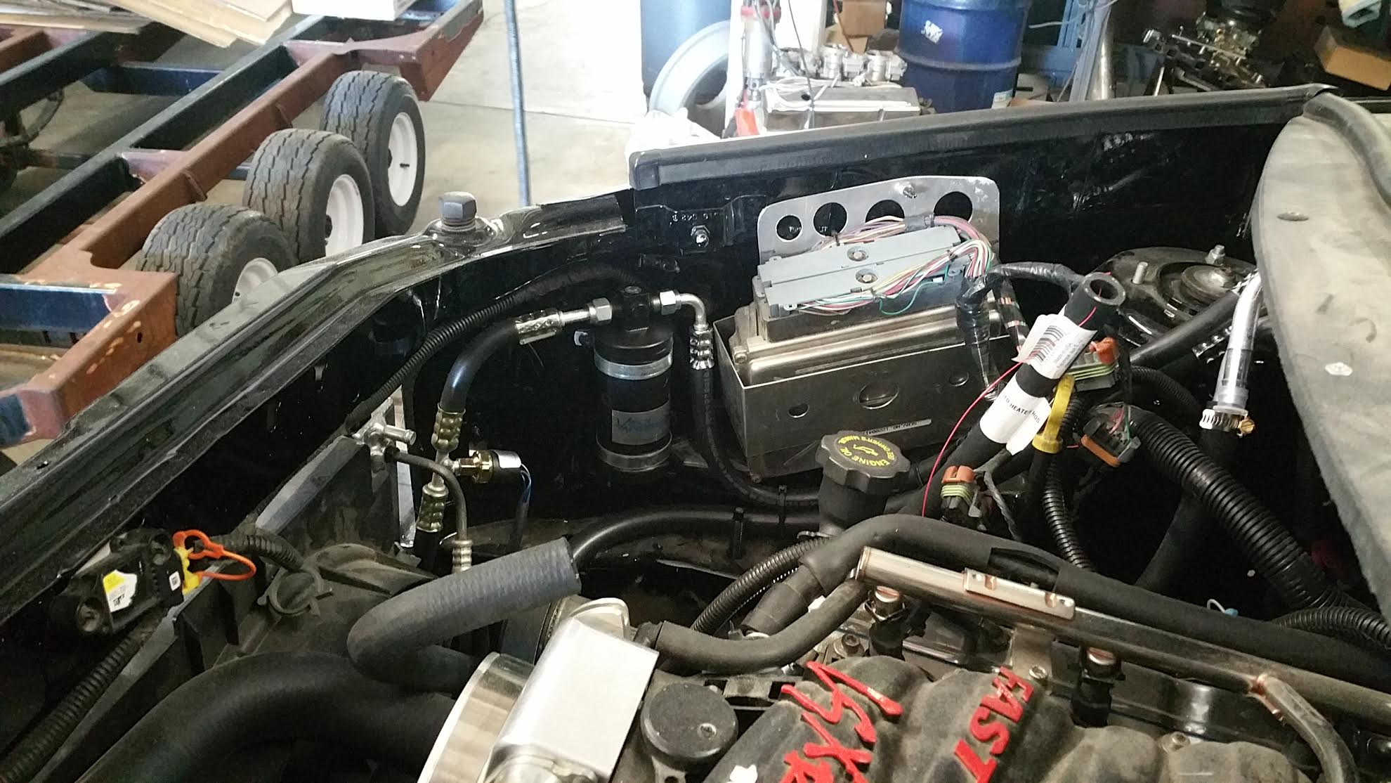

A Couple More Things
As you all know, things are more complicated than the SEMA cars because I want the creature comforts of a real driver, not a concept car. To this end the heater/defroster/a/c system has been extensive. At this point there are no original parts to the system. It's all Vintage Air and Dakota Digital now. Even the a/c condenser in front of the radiator had to be replaced. And of course a custom machined bracket to fit it to the Camaro radiator must be made. It never ends. This first pic shows some of the hoses and the drier for the system.
The Corvette C5 brakes are complete.

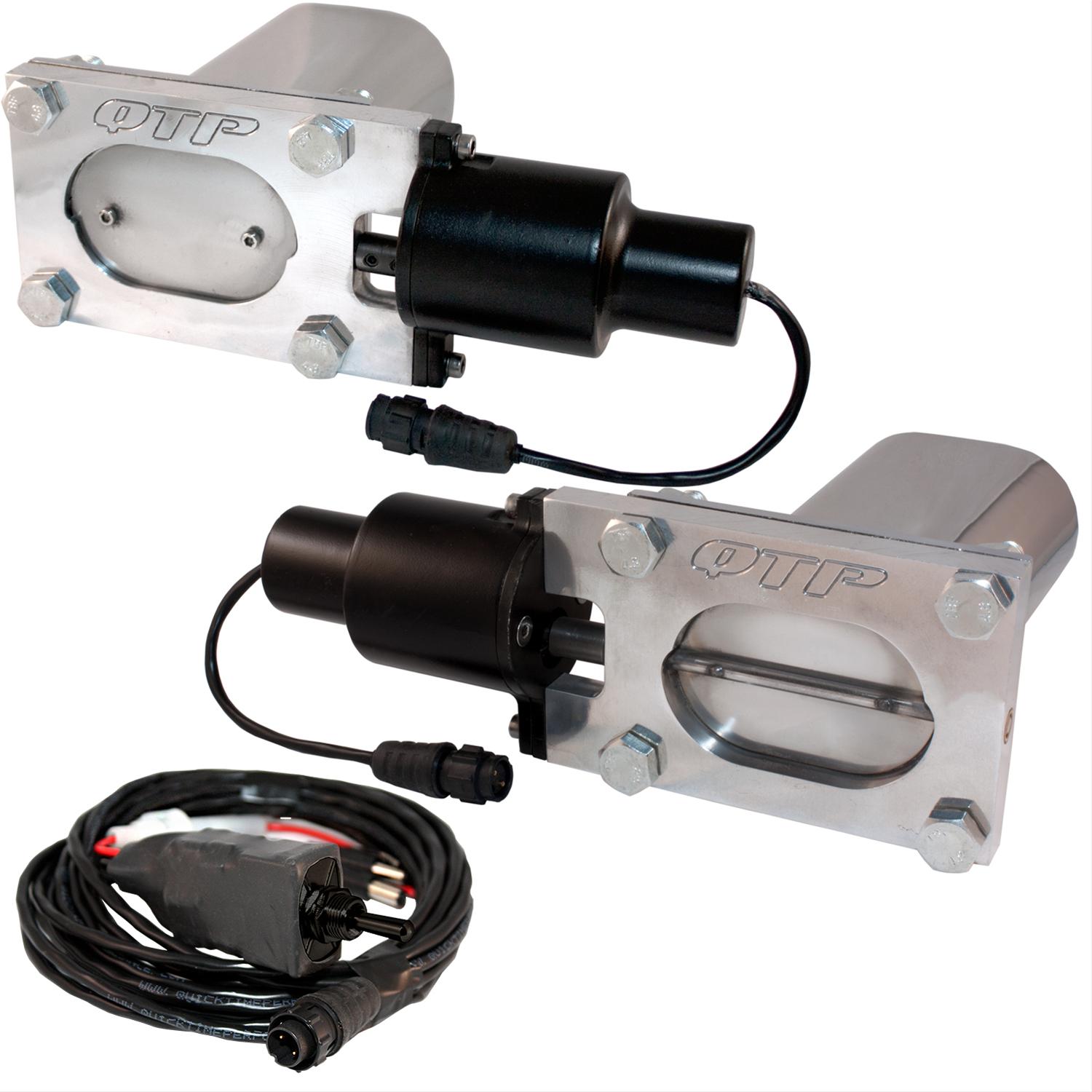

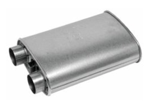

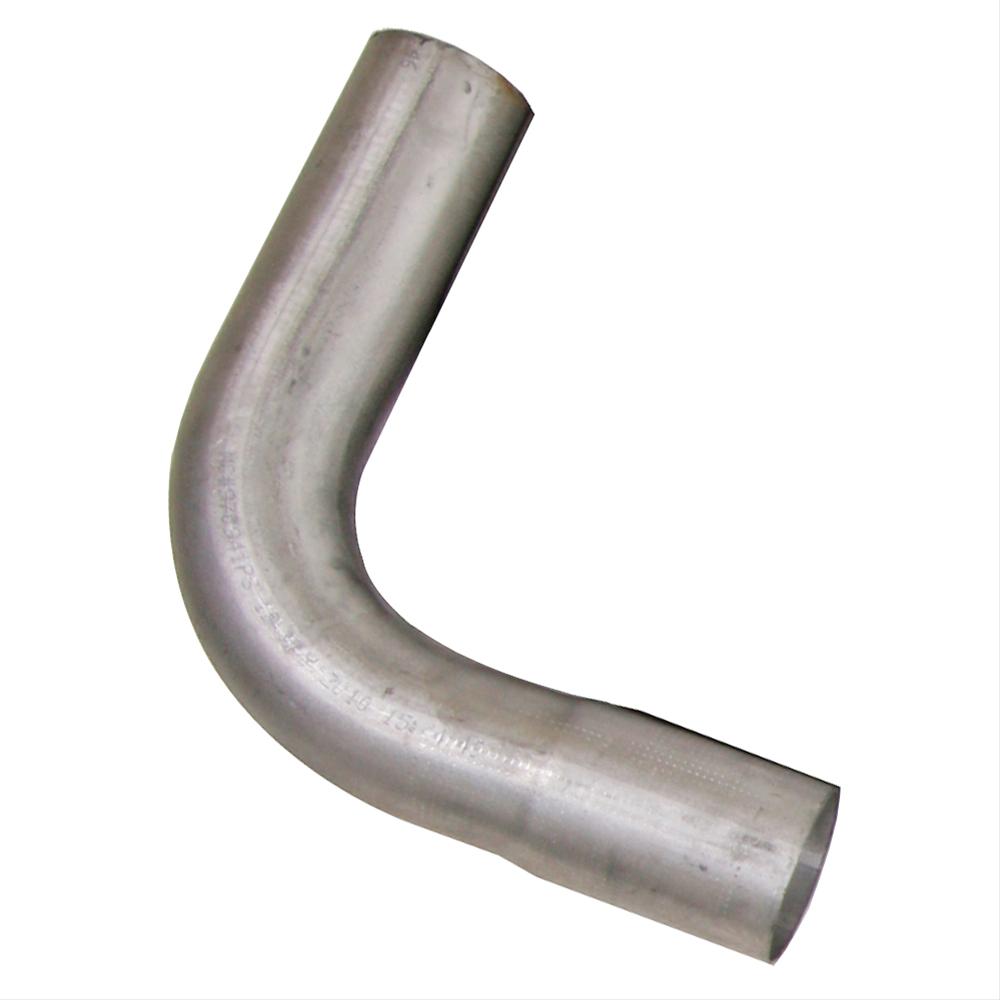

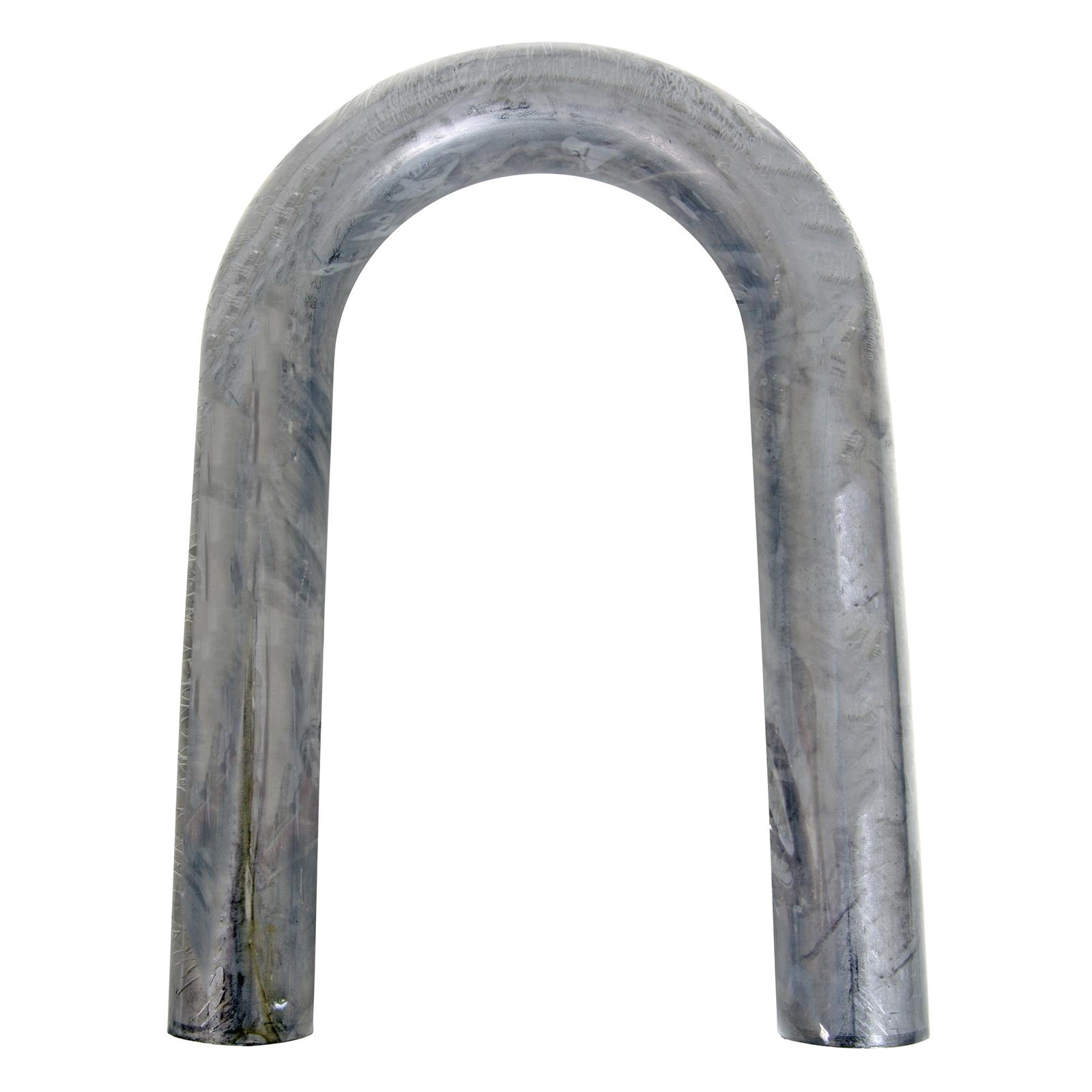

Exhaust System
The exhaust system will be made of 16 ga. aluminized mild steel. 2 1/2" dia. mandrel bends a straight pieces cut and tig welded together. Once it's welded it will be belt sanded and jet coated ceramic silver. I previously explained, the exhaust needs to come out the sides and not the rear so I had to locate a pair of pretty strange mufflers to fit in front of the rear axle. In front of the mufflers will be a pair of QuickTime low profile electric cut outs. The system will be removable with stainless "V" clamps aft of the cats. Should sound pretty nasty with the cam I'm running.

Posts: 40,083
those mufflers look similar to the 70 'Cuda mufflers with the side exits in front of the rear wheel inlet and exit both at the front
That's what I was thinking when I read the post given I owned a '70 Cuda AAR in a previous life. :-) Wish I still had it... :-(
