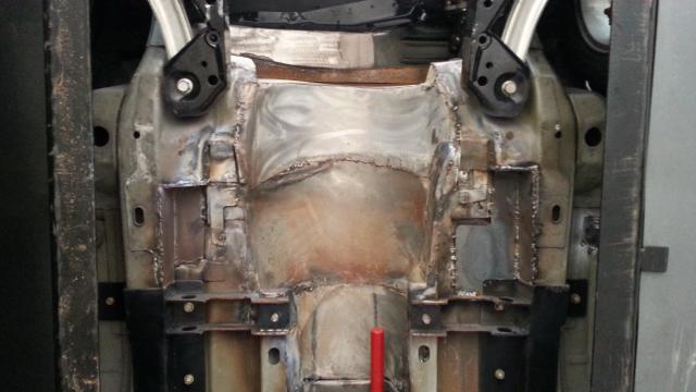

Cat Boxes Complete
Today I finished the cut out areas for the cats. I still need to do some grinding and any welding areas I might have missed. This shot is taken with the car up on the lift and me laying on my back on the floor. I'm really hoping I have enough ground clearance for all this stuff I gotta put in. I'm now getting into areas that YearOne and Unique never went....making it a REAL driver.

What u are doing is incredible, so will it be small cats like an HHR or much larger?

I have to use the Camaro cats so the computers will recognize them. Cats are very particular on where they are located. Too far away from the headers and the O2 sensors won't work right.

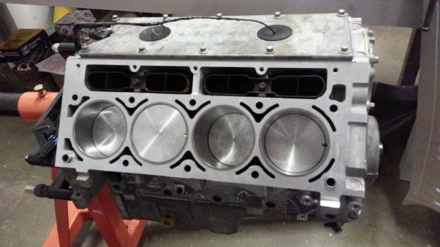

Another engine picture
The engine is coming along. The long block is complete. Heads are next week. Intake is ready for install as soon as heads are on.
