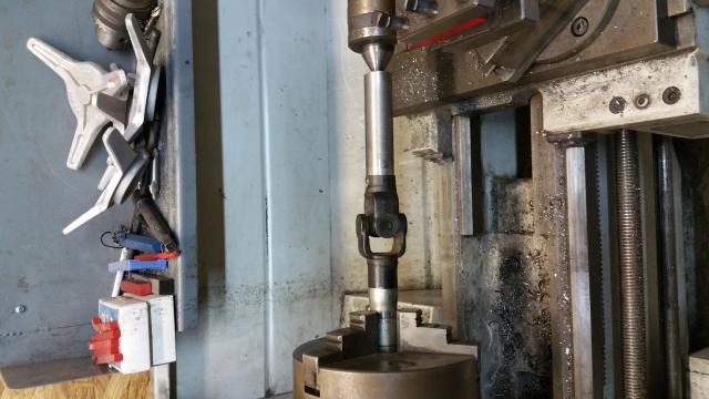

Having to add another colum support has required me to extend the shaft by 3" to accommodate a 1" bearing I'm adding as an additional support. To keep everything straight I machined the parts and then welded it while still in the lathe. Tomorrow I will make and weld in a boss for the bearing to ride against. This will probably take me a couple of days to get this steering column finished. In the back ground on the shelf you can see the 4 Moon castings (used for knock off caps on Moon tanks) that will be machined into the wheel knock offs. That's a project for another day.

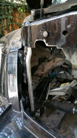

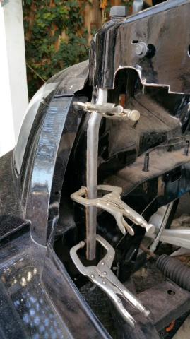

Finishing off the engine compartment getting ready for paint. I got the steering support finished so now it actually steers! All the welding in the compartment is done, and the firewall looks pretty good. Today I made the pieces that finish off the opening around the radiator. When I cut the opening for the Camaro radiator I just sliced the larger hole. The edges didn't look anything like how the factory would have done it. To this end I finished it with an edge that looks correct. On Sunday I'll load it onto the car trailer and take it to the paint booth on Monday. The car also needs to be color sanded to finish off the paint.

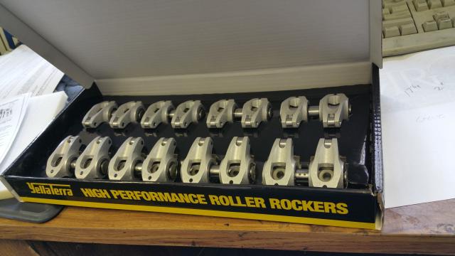

We're having fun now
More fun pieces of the puzzle are coming in almost daily. Here's the latest.
