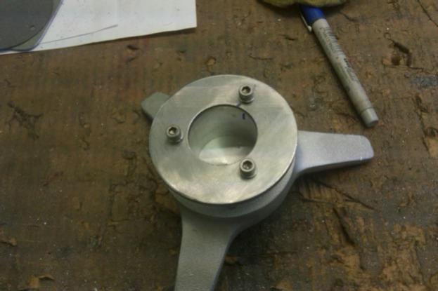

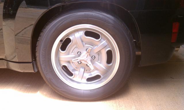

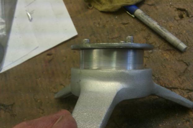

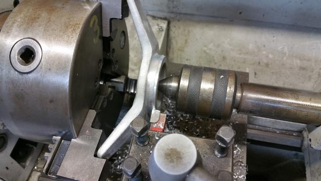

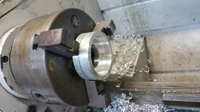

The car is at the paint shop, the engine is still at the engine builders, what's a boy to do? Work on other stuff, that's what. One of the things that I feel really set off the Moon Speedmasters are the knock-offs. When I bought my first set of these wheels from Moon in Santa Fe Springs, they had an HHR in their parking lot with these knock-offs made from the caps off Moon fuel tanks. I wanted to buy a set but they told me they were one-offs, prototypes that were NOT going into production......too much work. I convinced them into selling me some sand castings that they use for their tank caps and they were kind enough to show me how they made them. Here is the process that I used to make them. Quite a bit of lathe time is required to do these but I for one really like them.

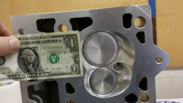

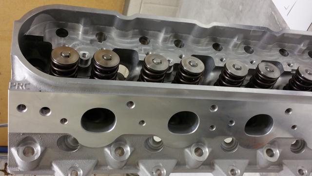

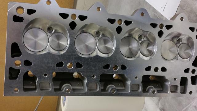

Got my new heads in today and they were worth waiting for. They came from Texas Speed & Performance. New castings, full cnc, dual valve springs with titanium retainers. 2.06" valves, everything possible on Ls heads. Couple this with the Yella Terra roller rockers and I think it will scream. Taking them to the engine builder tonite!

Just that the change from about $2,500.00 for those heads?
Yes, if you don't count the rocker arms.
