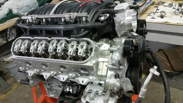

Went by my engine builder's shop tonight. I delivered all the items that he asked me to get. I am amazed at the care he is taking building this engine. It's not enough to have the very best parts available, everything is hand assembled, measured 3 times and lapped to fit. I guess I shouldn't be surprised, he has built the engines on several world record holder drag boats. He is super particular on the valve train. It's been in and out several times. He is machining .0015" off the rocker arm mounts to get the rollers exactly in the correct location. I had to see what the rockers looked like so I just set them in without bolts and took this picture. Soon it will be ready to install. We are shooting for next Thursday.

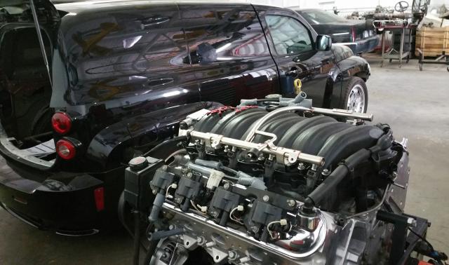

Engine & Body in Same Room Again
For the first time in many weeks the engine is alongside the body again. We were shooting for installation tomorrow but it will be next Wednesday the 25th. Too many loose ends to deal with. We're not in a hurry and it is sooooo much easier to work on it while it is on the stand. It's going to be filled with oil and Lucas break-in oil and then we crank it to check for oil pressure. The engine wiring harness will be installed and hooked up to a Sun diagnostic machine (without the ECM) and checked before it goes in the car.
Speaking of wiring harnesses, the OEM split plastic wire housing is getting removed and replaced with a tight mesh tubing that is sort of like those Chineese finger things. Should look much cleaner. As you know, this car will be put under a microscope everywhere it goes and I don't want to hear "you should have done this or that"
