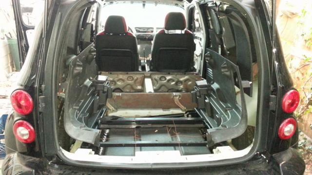

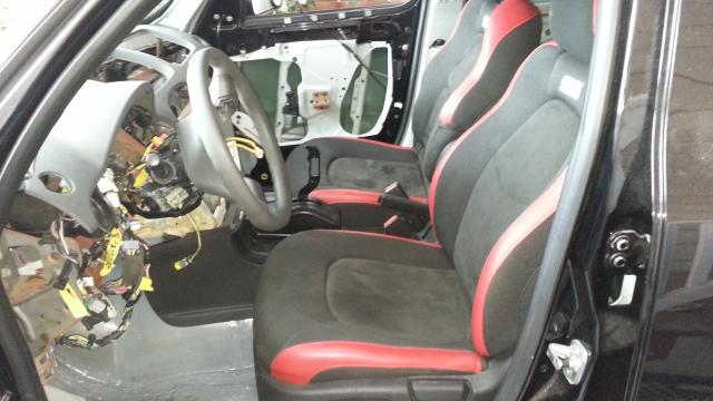

Test-Fit Interior
Began to put the interior back in the V8 Panel today. This may sound like no big deal but I have changed so many parts on this thing I need to know how it's lining up. Had to "hot wire" the drivers seat to move it to the rear. As anyone knows that has removed the driver's seat, it must be moved to the front position to get to the rear bolts. I'm putting it in a car with no wires and no power. I hooked a 12v battery to some wire leads and powered it up to move it into position. The shifter sits just right. I can't wait to be banging it wot thru the gears. I still need to bend the brake pedal arm to the right about 2" and fabricate a gas pedal.
The second photo shows just how much I'll have to cut out of the inside rear plastic interior panels. Right now the spare tire section hits the sub-frame, coil overs, rear axle, panhard bar, gas tank, etc, etc. Once these panels are cut to fit I will get serious on finishing tubbing the rear wheel wells and finding out just where I can mount the full roll cage I'll be making.
So as you can see, I have a long way to go.

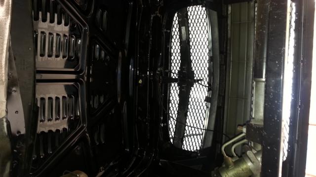

Weird view
Still working on the undercarriage, cutting notches for the cats, finishing up the welding. While under the car I looked up thru the hood louvers and saw this strange view.
