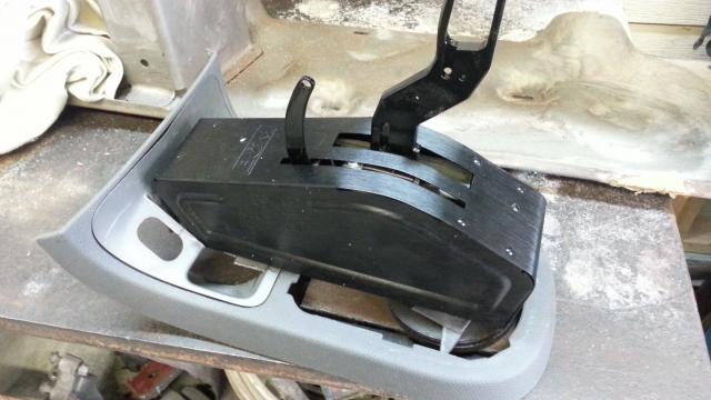

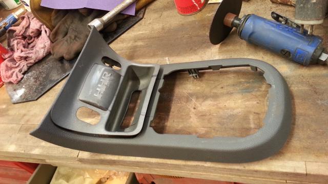

Since the engine is away at the rebuilders, I've been continuing on the trans and the hump. I figured it was time to locate the shifter before I built something that will have to be modified later. With that in mind, I spent the day modifying the plastic around the shift lever. The B&M ratchet shifter is pretty large so I had to cut into the area that says "HHR" between the window switches. The window switches are moving to the doors (where the should have been all along) so those 2 holes are getting filled as is the flat top area that is on the sides of the shifter. I used a cut-off tool and heat gun to soften the plastic to bend it around. Monday I will begin with the 3M stuff to adhere the new parts that will be added. Parts like these take a very long time to complete. I expect 20 hours or more in this plastic part by the time it is painted and finished

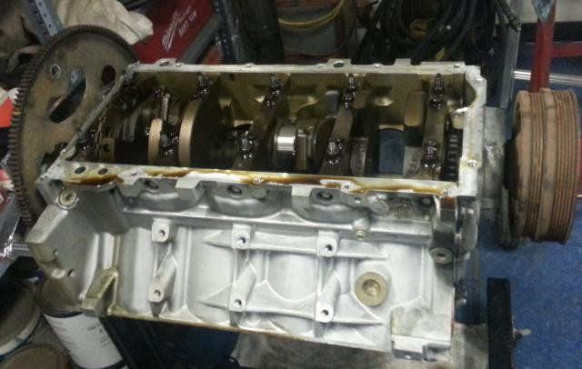

Well so far the engine looks good. The cylinders will only need a 10 thousands hone to get them right, the crank has minimal wear and only needs a polish and the rods look good. Of course everything needs to be magnafluxed to know for sure. The rods may get replaced anyway. I hope to send it to the machine shop soon. Cam selection will come soon, it depends what happens to the heads.

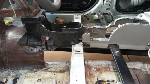

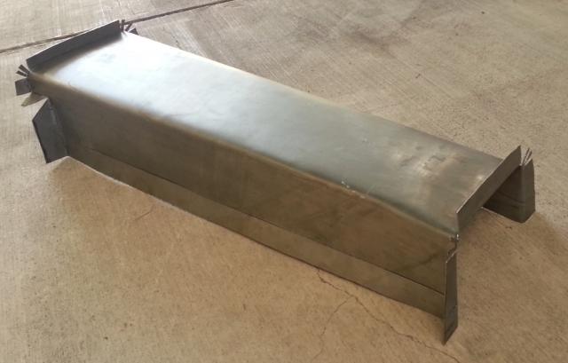

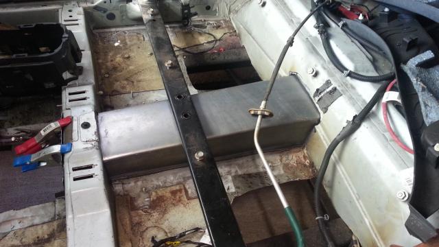

Spent the day building the drive shaft hump. I started out with cardboard for the template, transferred it to 19 ga. sheet and cut it out with a stomp and a Beverly shear. Bent it up with a bead roller and after about 20 trial fittings it's in! Tomorrow I'll fab up the rear section of the trans hump and begin welding. I hope to get this part almost complete over the Labor Day weekend. Here is what I have so far.
