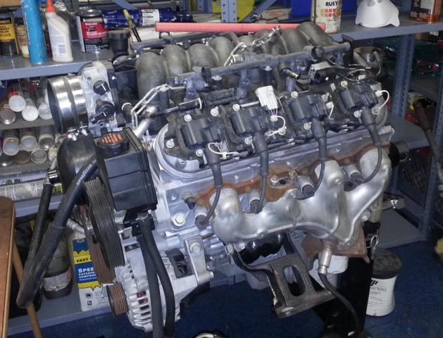

Engine Tear Down
Well here is the Ls1 on the stand at the engine shop. Tonite begins the dis assembly and inspection. The heads are first so they can go get in line for the cnc porting machine. Once the block is stripped down we can measure everything and figure how it will be machined. Once the machine work is started I can order parts for re assembly. Really excited about this part.

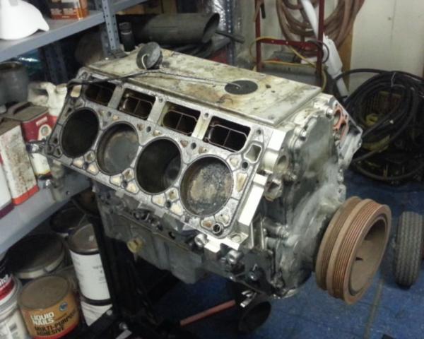

Engine Tear-Down cont.
Well we pulled the heads and guess what? Somebody put 2 sets of head gaskets on this engine. Maybe there is a warped head. Why would someone not fix the problem? Two sets of head gaskets is just stupid. Oh well, the cylinders are over by about .006" which is acceptable. As soon as it's flipped over we will pull the pan and inspect the crank. At that time I'll be able to tell which direction this motor is going. If the crank can't be saved we will get a stroker crank. If it's good we will just go 10 -20 over with a stock crank.
Either way. It will be a strong runner.

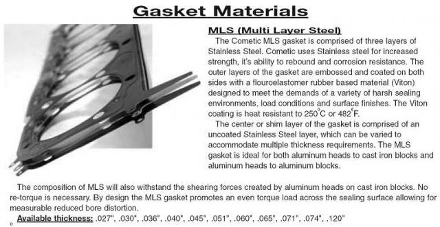

I do know that the LS1 engine uses MLS gaskets (multi layer steel). Is that what you see or is there really two complete sets?
I would guess that to install two gaskets stacked up would be pushing the hydraulic lifters to there max travel or the head/rockers has been modified to keep clearances correct.

Originally Posted by Lucky
I do know that the LS1 engine uses MLS gaskets (multi layer steel). forhat what you see or is there really two complete sets?
I would guess that to install two gaskets stack. The up would finishedg the hydraulic lifters to there max travel or the heads has been modified to keep clearances correct.
My engine guy says 2 sets and he has done a lot of ls motors. In any case, I cant wait for this thing to be all shiny and new. A lot will happen in the next few weeks as far as the motor goes. The trans is finished, sitting on the bench.

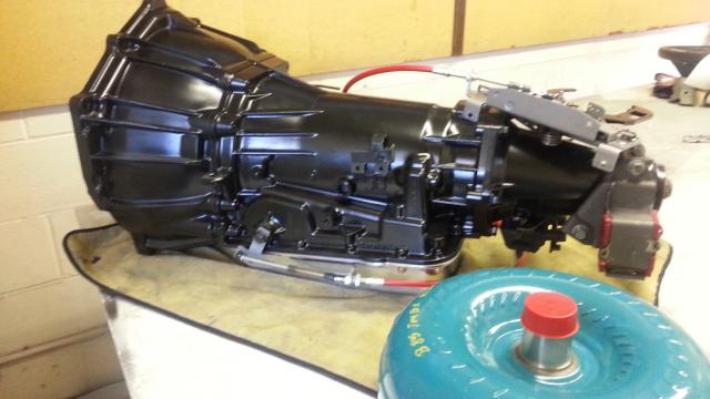

Old Aug 14, 2014 | 01:04 PM
  #280
lasater's Avatar
Joined: 04-06-2010
Posts: 655
From: Riverside, California
Trans Done
The next time you see this gear box it will be mounted behind 500hp of Ls1 engine.
