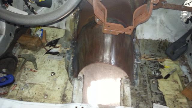

While the engine bay is empty, I'm working on the trans hump first. It is almost done with the exception of one 8" section in the rear. After that, I move on to the drive shaft hump.
