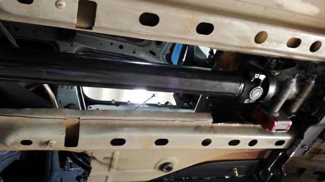

This is Important
I have spent many, many hours getting to this point, and if anyone in the future wants to follow me (fools) here is what you need to cut on the drive shaft hump. Using the torque arm setup off the Camaro requires an extra amount of room on the drivers side of the opening. The floor has to be cut and bent up about an inch away from the original "humped-up" area. This will clear the torque arm but much re-enforcing must be done to compensate for this. I have also decided on a full roll cage in the panel. I think the stiffness a roll cage will add will be required.

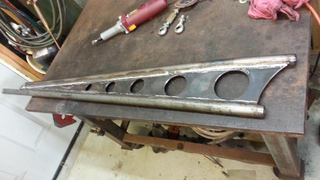

ready for Powder Coat
Torque arm is complete, ready for powder coat. I'll take it in Monday and install it on Friday.

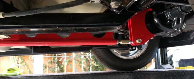

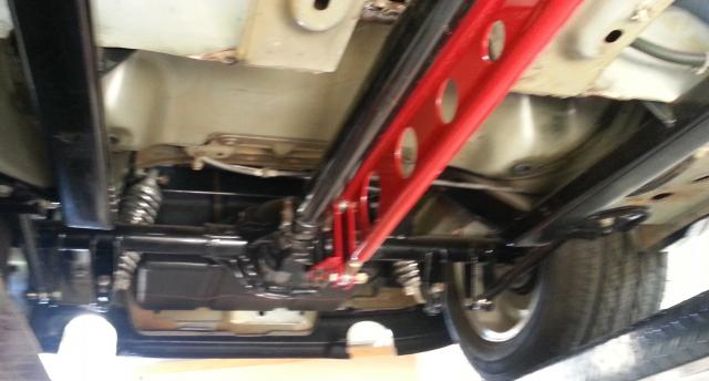

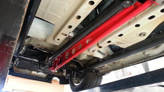

My Rear End is in the Right Place
For the very first time I have the rear axle in exactly the right place. the tires are centered in the wheel wells, the track is the same inside the fenders and the third member is at the correct angle in relation to the drive shaft. Got the torque are out of powder coat today and just installed it.
Now that everything is in, tomorrow it all comes out to continue on the sheet metal work in the trans/drive shaft hump. I'll pull the engine and trans too as I will be taking them in for rebuild on Monday.

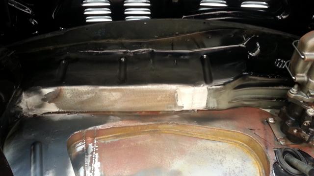

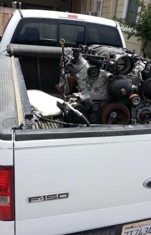

Off to the Engine & Trans Shop
The engine and trans are loaded up and ready to go. Should take about a month for the engine and a couple weeks for the trans. It will be sweet when I pick them up, I'm really excited.
I'm also including a shot looking up from the engine bay at the mods I did on the rain trough under the cowl. This was really quite a lot of work to make this piece go straight instead of sloping down. I had some clearance problems with the right head that required this.
