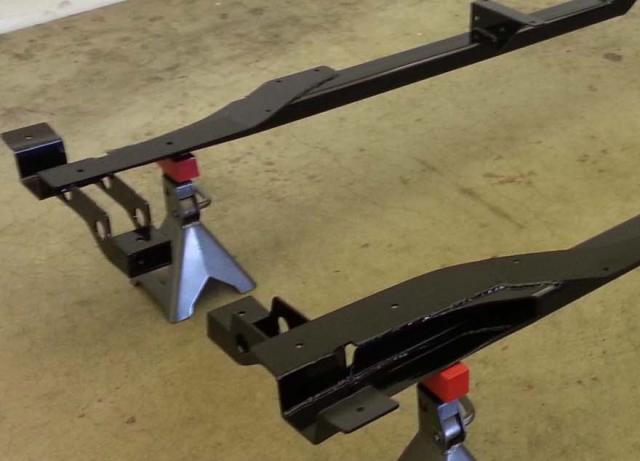

This may be a stupid question but did you ever think about building your frame with round tubing instead?
Actually no, I didn't. Three reasons; 1. The weird angles of the bends were pretty easy to accomplish in wood and then transfer them to rectangle tubing. 2. I'm not that good of a tube bender. (Wait till you guys see the roll cage!) I don't think I could have duplicated the two sides by bending tubing. I might have been OK with the first one but a mirror image....I don't think so. 3. The brackets that sandwich the sheet metal floor are much stronger welded on to a rectangle verses a round tube.

Posts: 40,091
I've always used rectangle tube for the frame and round tube for roll bars and nerf bars on my race cars and a few pro street cars I built back in the 90's and I concur with you much easier to match curves and angles and much stronger !

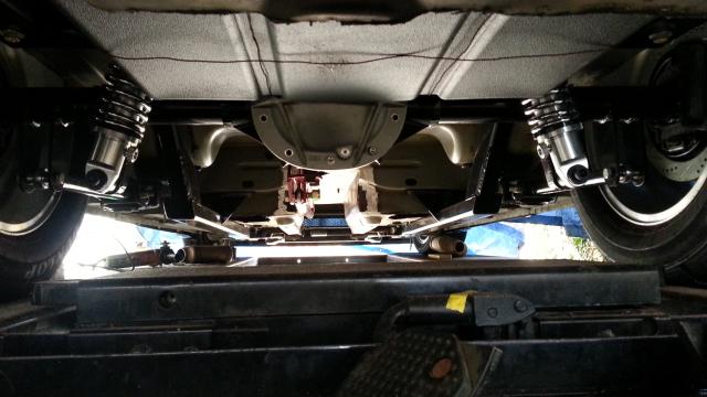

A view from under the car
As I continue to work on the cut out areas for the cats to fit I snapped this shot of the undercarriage. I don't know if I have posted this view or not . Anyway, I thought you might like it. And yes, that is tie wire holding the fuel cell up. Another thing I am starting on is the gas pedal since I'm in the area. I am using a Lokar Eliminator pedal (new school ) with a rectangular Moon (old school) pedal replacing the billet aluminum pedal. I'll post pics of that next week.
Old Dec 5, 2014 | 05:11 PM
  #360
Posts: 40,091
Artwork man pure artwork!
