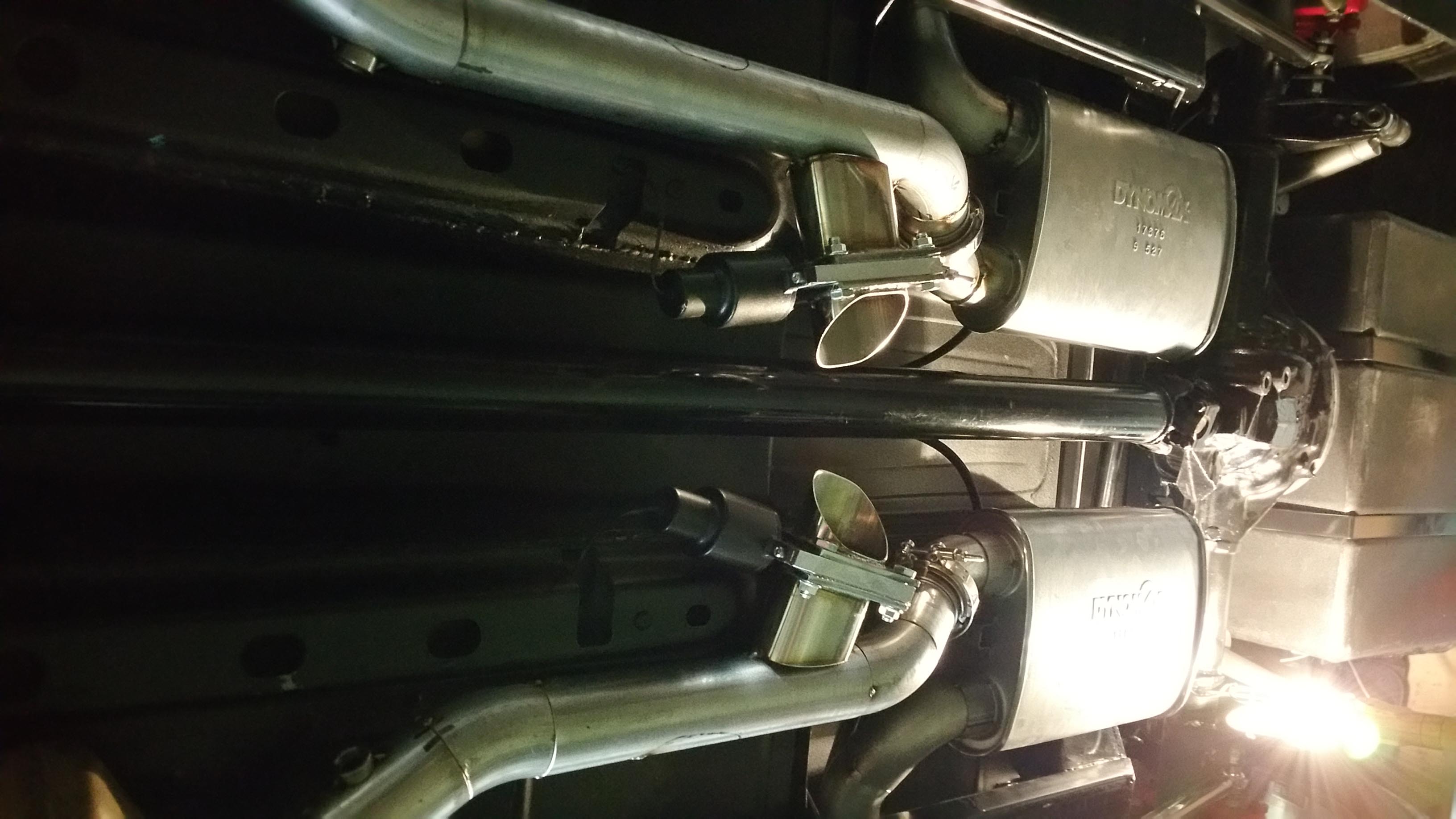

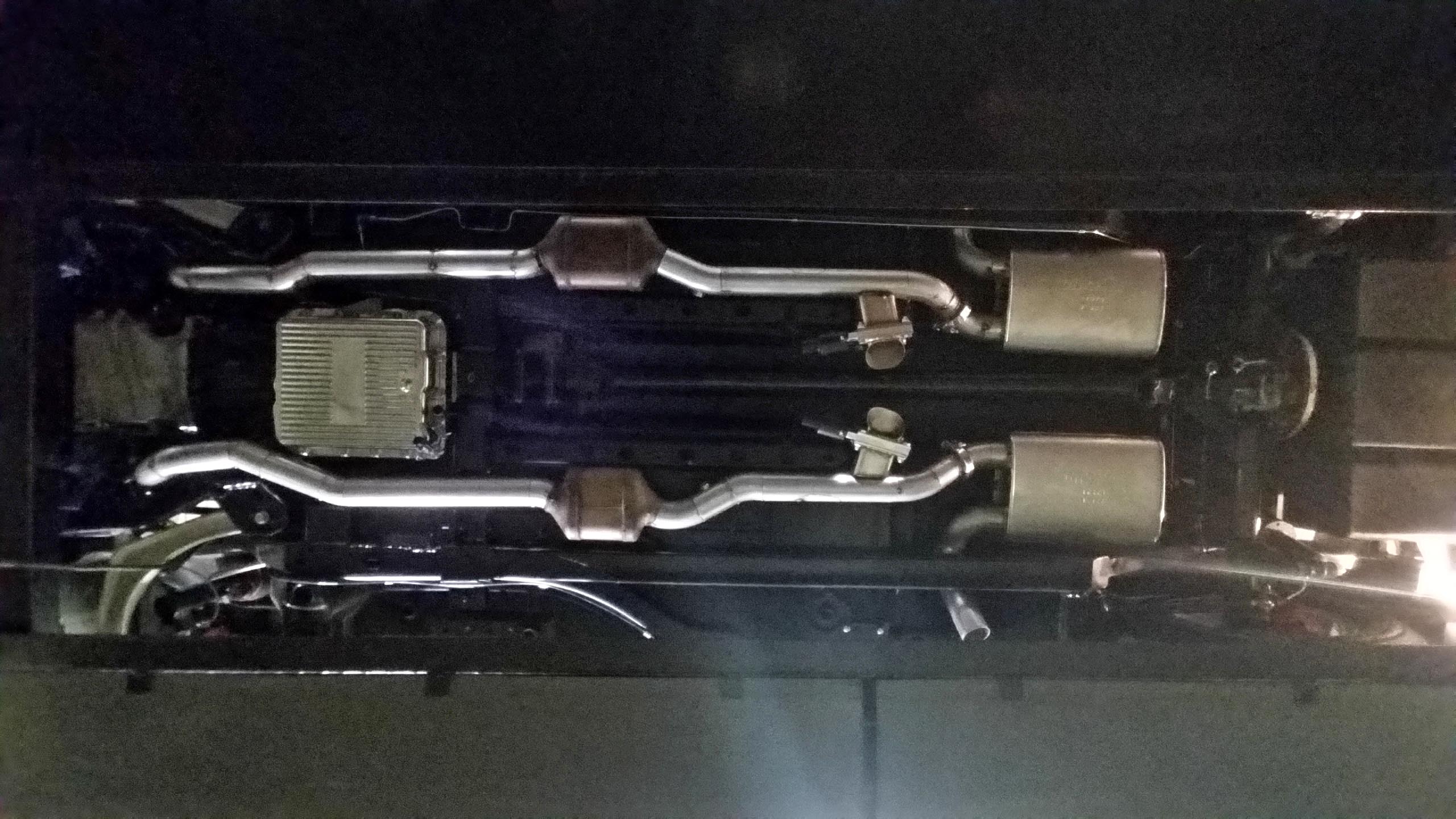

More Exhaust Progress
Here are a couple of pics of how the exhaust is coming along. Didn't have very much room for the cutouts so this is about the only location. The system should be ready for jet coating by next week.
If you look at the drive shaft you will notice that it is not centered. This will be adjusted to center with the panhard bar. We just haven't got to that yet.
