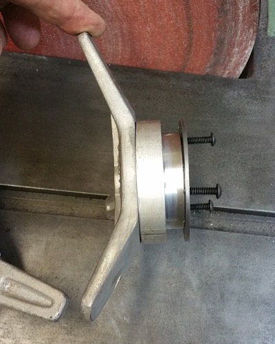

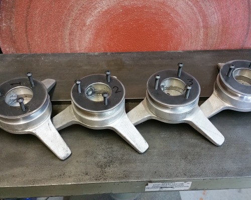

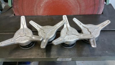

Moon Knoch-Offs Complete
This is a little project that has been on the bench for quite a long time. I finally got around to finishing the hock-offs. A fair amount of lathe and drill press time is required to make them but now this little piece of the puzzle is complete

Old 02-07-2016, 04:36 PM

Posts: 36,580
Cliff, we need pictures man! You know or it didn't happen !
Okay fine

Posts: 36,580
Awesome work!!! That's better! Aaahhhhh!!

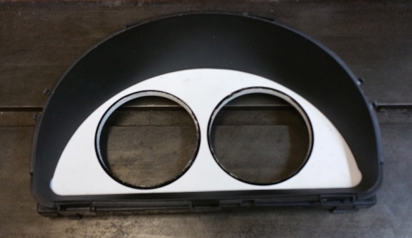

New Instrument Panel
Well, as luck will have it, the ECM on the HHR's are can-bus. The ECM on the Camaro is Serial. What this means is the HHR instrument panel won't get an input that it can use from the Camaro ECM.
To fix this I'm building a new instrument panel with Speedhut guages. I ordered the guages today.....about 2 weeks till they send them to me.
I removed the stock cluster and made a template with it. I then cut out some 1/4" PVC sheet to fit the shape and cut 2 - 3.30" holes in it.
Then I doubled up the PVC sheet in the attachment areas.
Then I covered in in carbon fiber.
Here are the guages: 160 MPH Speedo and a Quad guage for all the esentials.
I don't need a tach 'cuse I'm using my vintage 1962 Sun tach from high school on the top of the dash.

Posts: 36,580
Very cool! That'll be an easy on the eyes gauge pack!
