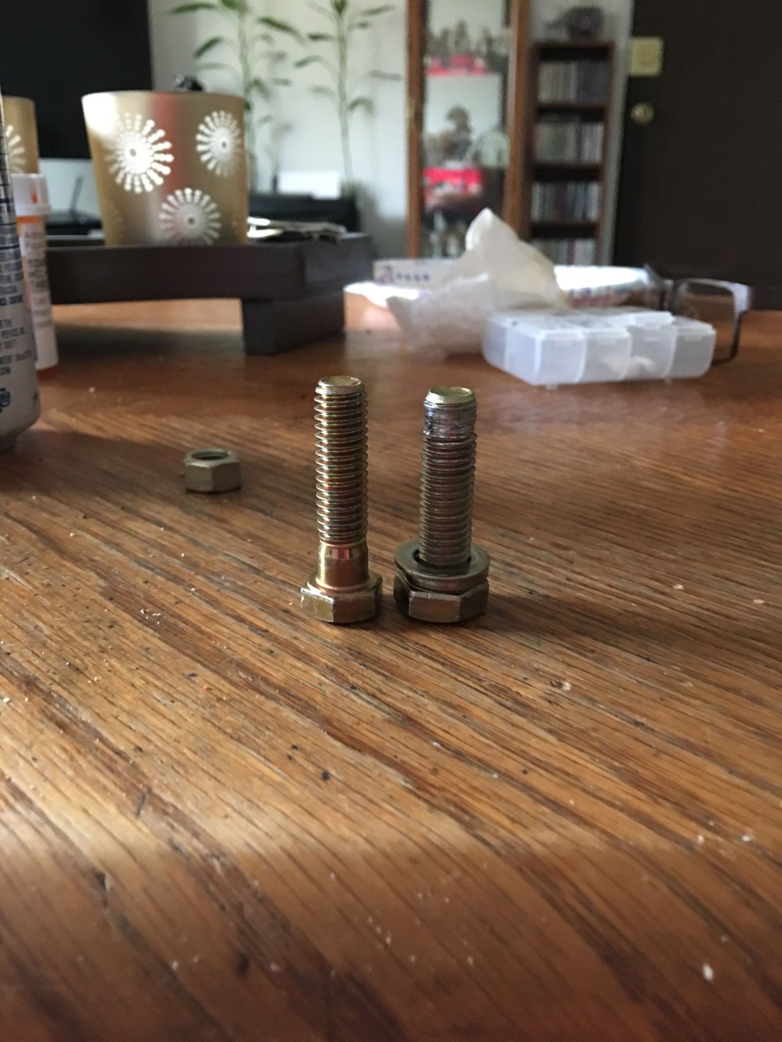

Originally Posted by hurst2001
yea just got these it was a great price and the rear bushing look a little better then stock plus the ball joint has a grease fitting , not a bad price at all lookin at about 60$ apiece.. and fast shipping a plus ..
Well got the one side installed drivers side by the shop well it was pulling to drivers side wtf ? Well took back to the shop and they found that the ball joint bolts were loose and tried to tight them up and these bolts Started too strip because they were too short .. the bolts are only 1 1/2 was like no way to get them tighter ... So I went and 2 inch bolt had the room to tighten up .. So be aware if you buy these control arms as far as the bolts ... They have the part number as moogs and seem good quality as far as the bushing ..
One one left is two inches and the other bolt that came with the control arm is 1 1/2 ...
Old Mar 30, 2019 | 02:19 PM
  #30
Posts: 26,533
What bolts? What happened to the originals?
