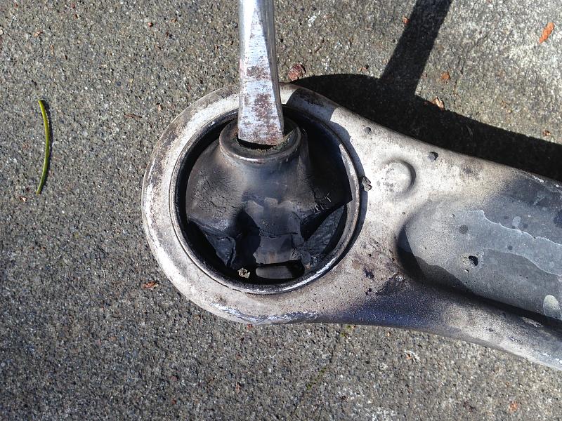

220K on the HHR thought it was time to work on the front end. The control arm bushings were shot and the ball joints were about done too. Replaced the lower control arms with Cobalt SS Moog problem solver ones. Took 22 minutes per side. Car drives much better. Almost no torque steer under power. Road feel is much better. A big plus is no more brake shimmy.

Do those problem solver LCA's have the rubber bushing or the bearing / bushing?

It came with the rubber one. I pressed it out and put the bearing socket type in. Im doing this one time. I tried to order one with the better bushing installed, but Moog will not do special orders. It was nice to every thing ready to go for the swap. The old aluminum control arms look very rough cast. Taking them down next week to have ultrasonic test done to them.

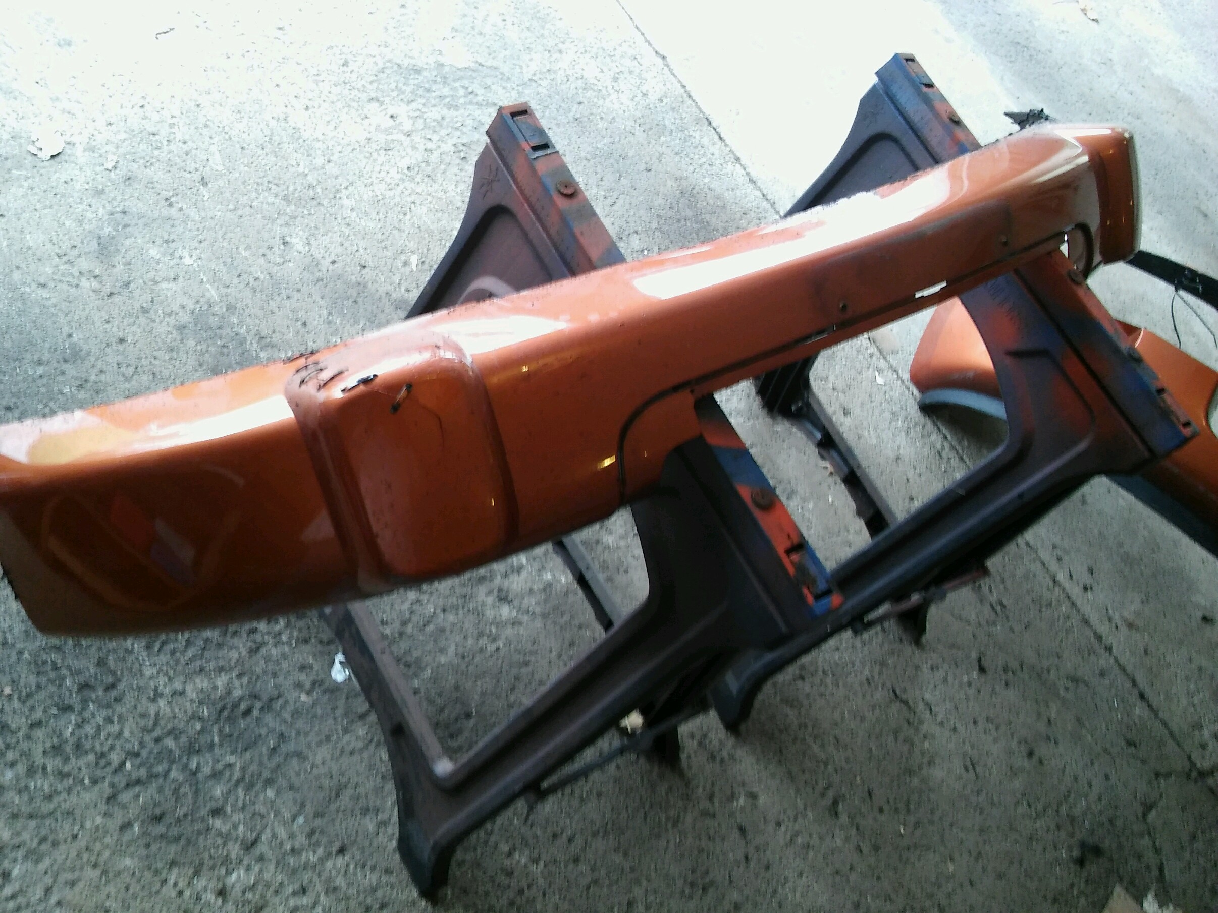

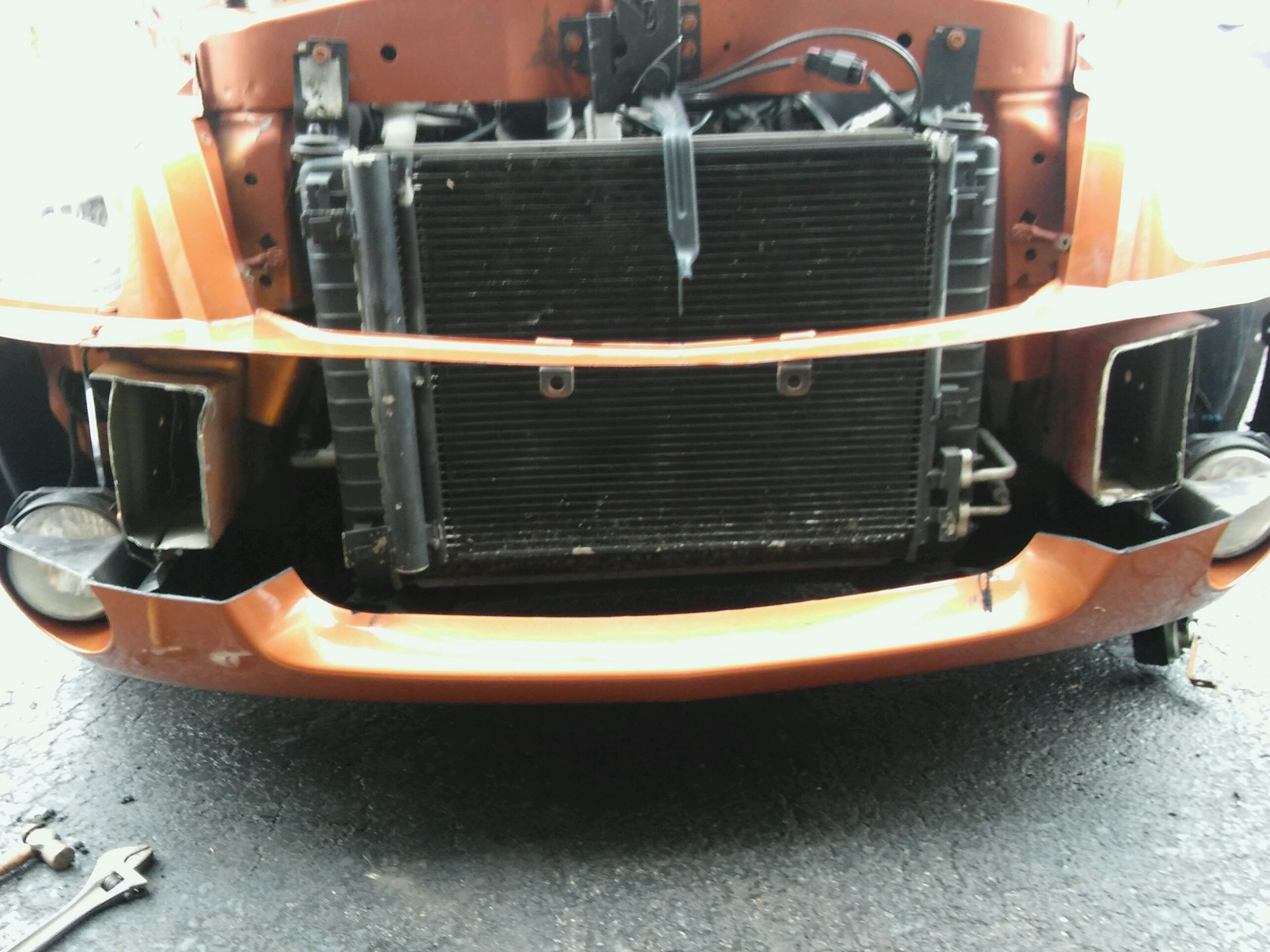

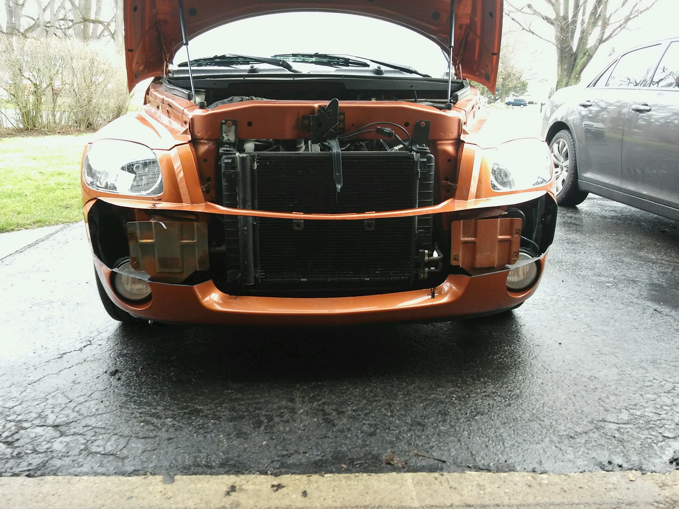

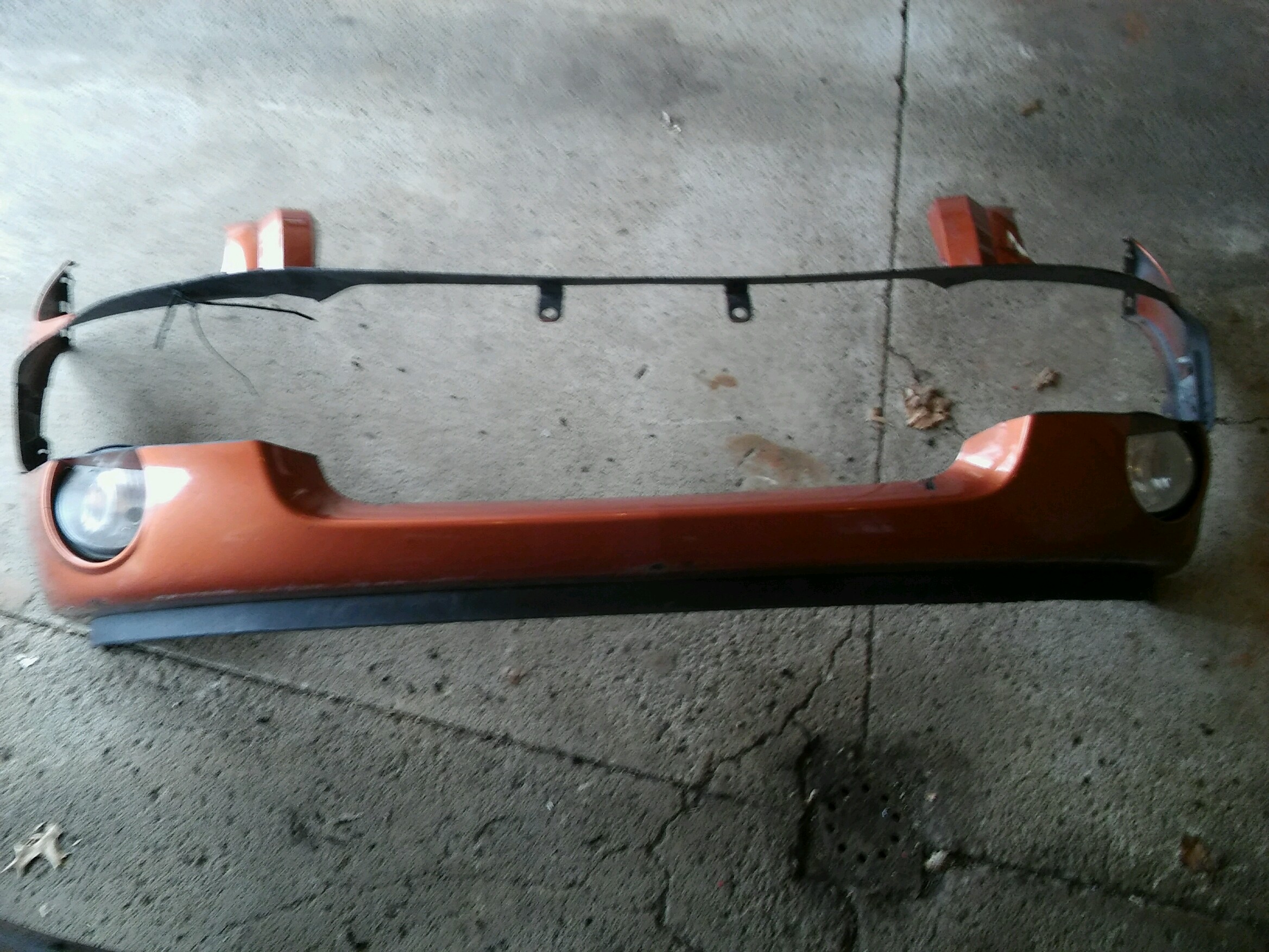

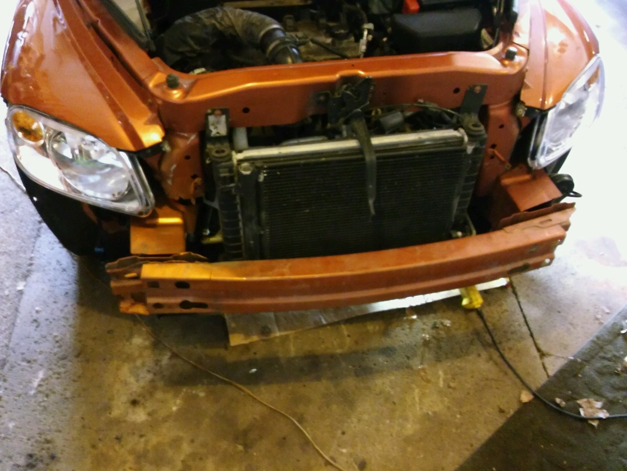

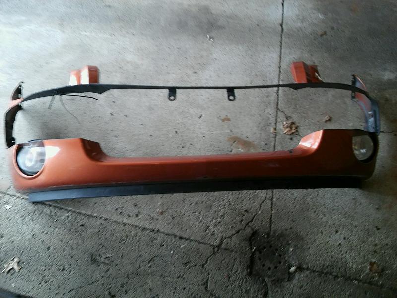

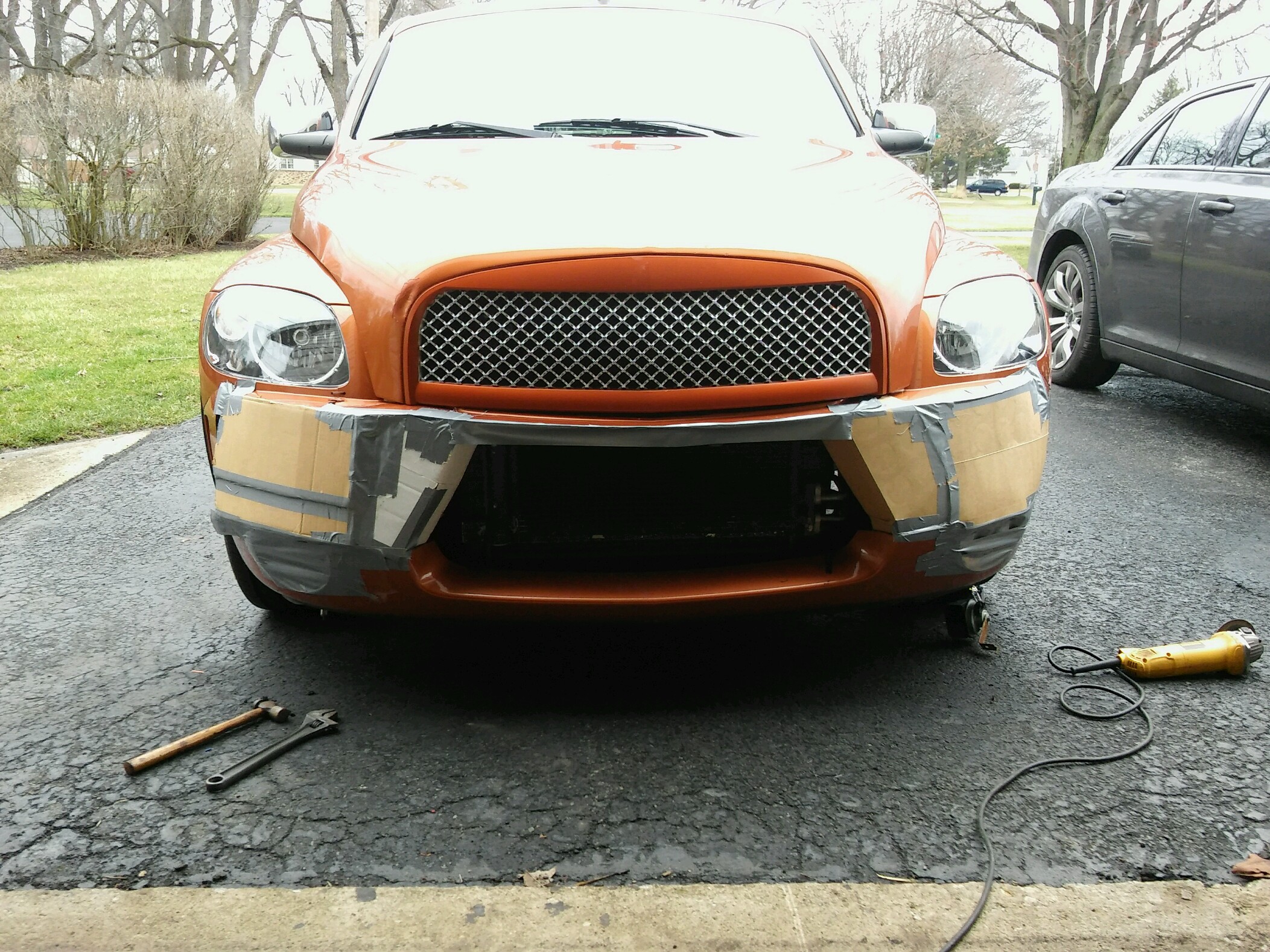

Talking bumper mod
got into modifying my front bumper today heres a few pics, almost ready to glass it

It looks like you no longer have frontal crash protection?

Or fog lights! Looks like a neat how to project!!
Frontal crash protection, he don't need no stinking frontal crash protection.
