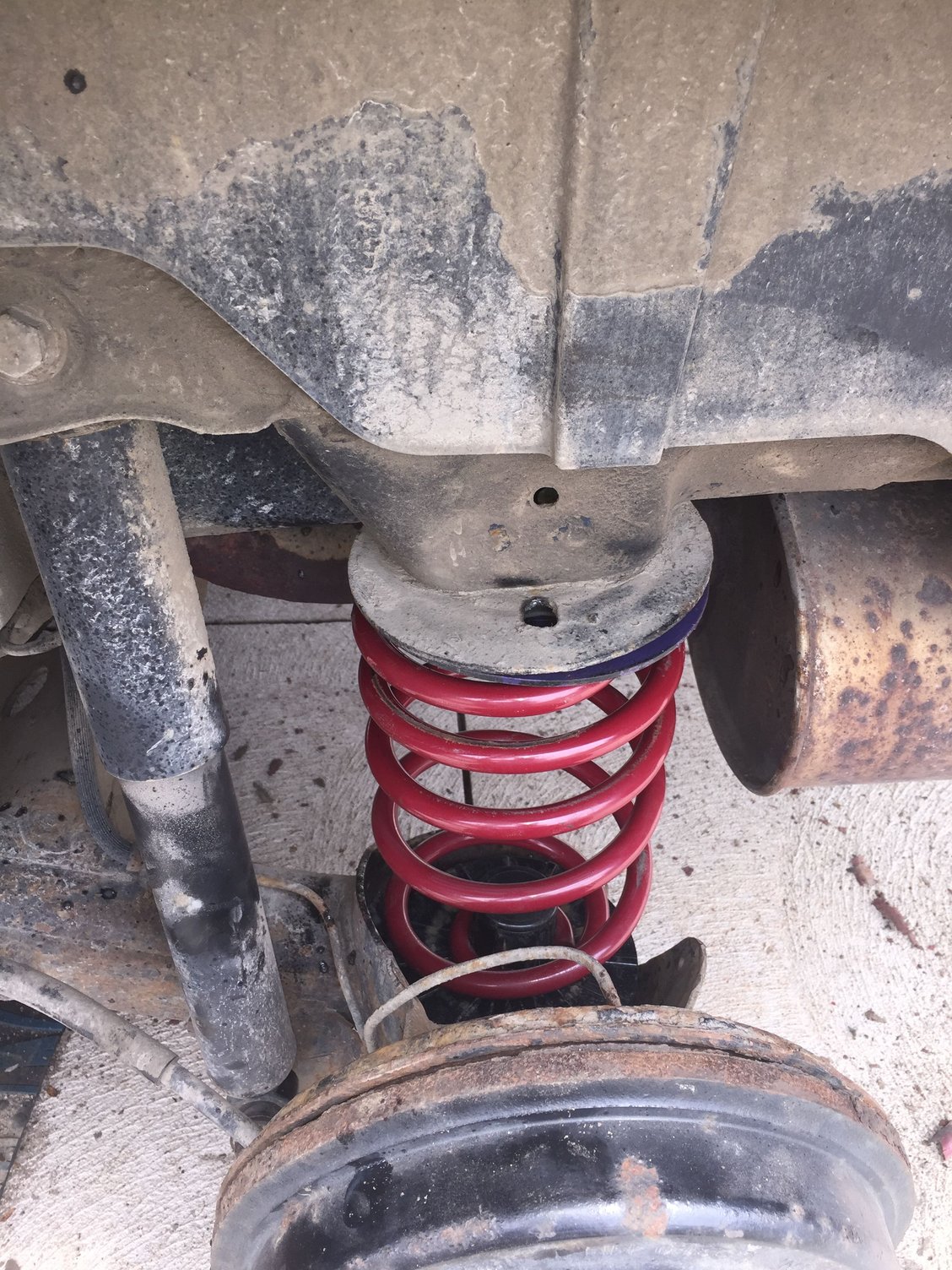

Today , changing the rear springs, the stock 18 hole steelies have a 42mm offset, while the WV rally’s have a 35 mm offset and with the new quarter panels there is contact.
I don’t want to cut or grind on the fresh sheet metal , so I’ll install the taller springs that came in my original Canuck Motorsports lowering kit.
Today is also 4 years since my bypass surgery for my heart artery issues. I’m still nuts as ever, my friend Dan’s wife , Linda came over and reminded me to wait till Dan came over to change out the springs. It’s nice that she reminds me not to get into deep, before I get into medical distress.
Tire rub on drivers side rear
Tire run on passenger side rear

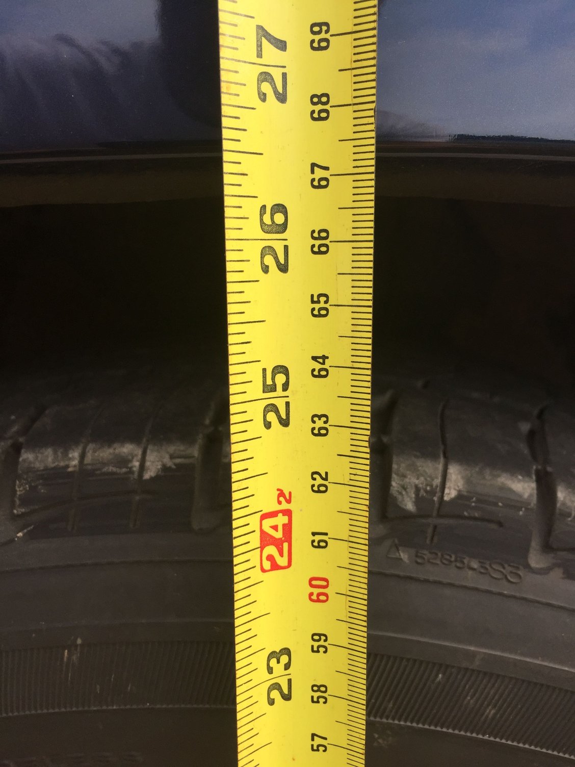

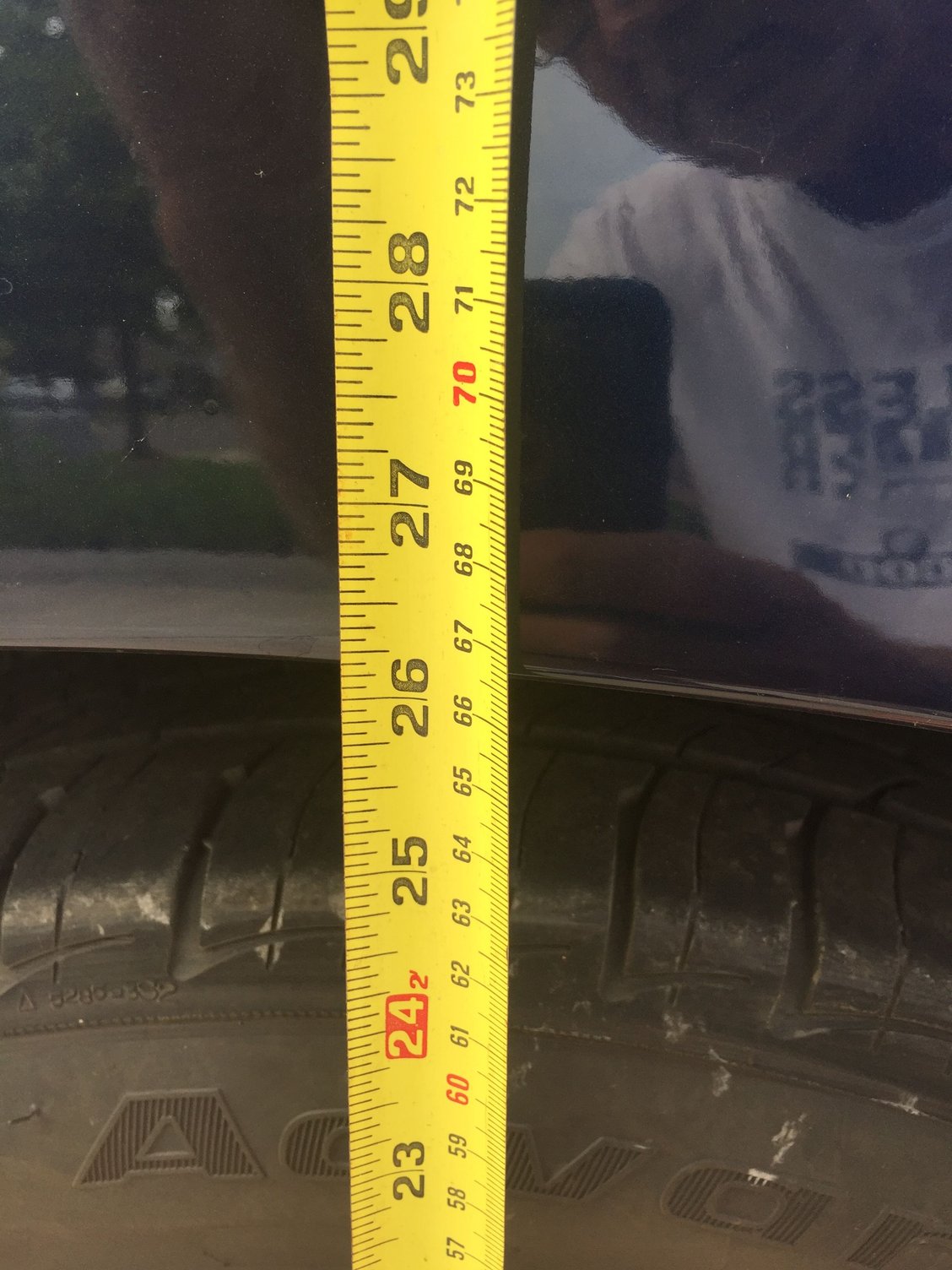

Well after a while and a short rain delay, Dan and I got the rear coils swapped out.

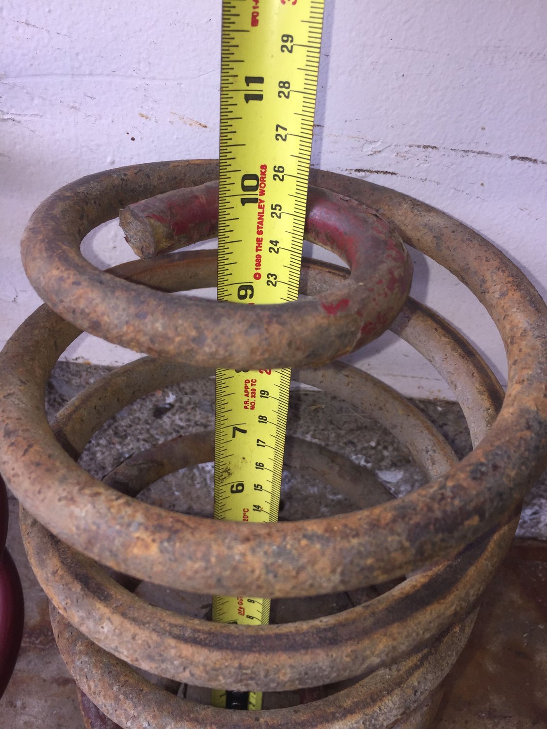

The old ones installed in 2012, are 1 inch shorter, but the ride heights aren’t that much different. We took a ride to Fort Erie for ice cream, 4 adults and no bottom out, fender rubs or rough bouncy ride.
Old springs, 26 1/8 ish
Old spring out 10 inches height
New springs 10 3/4 inches

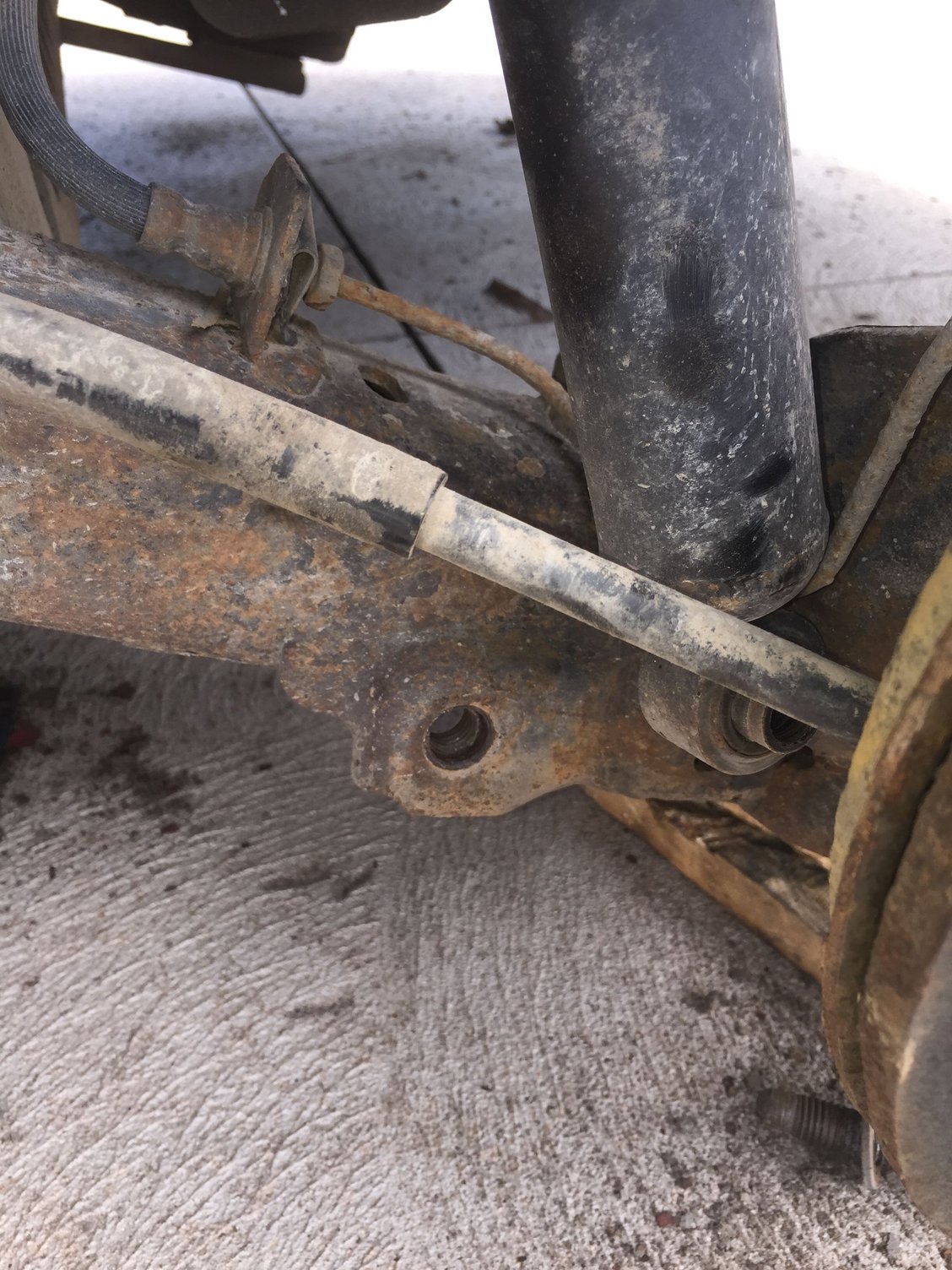

Yes we didn’t forget the brake line bracket nuts
We only removed the lower shock bolts, reinstalled them and torqued to 92 ft/lbs
New springs installed.

26 3/4 inches, 1/2 inch higher.
