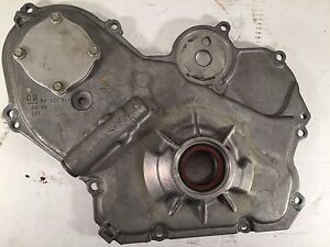

Originally Posted by Oldblue
I still hear a noise, almost like a cavitation whine, I think reusing the front cover gasket was a bad idea, the oil pump isn’t sealed.
I’m ordering a new gasket from RockAuto, hopefully that’s the problem.
So you think you're sucking in air somewhere around the front cover and it's causing oil pump variations?

Yes very much a possibility, if the gasket was compressed by over torqued bolts, the oil pump ports part of the gasket may not be sealing properly. The noise changes with engine speed between 1500 and 2000 rpm. I’ll post it up after I replace that gasket.
Seeing as the water pump bolt gets torqued to 18 ft/lbs and the serpentine belt tensioner bolt gets 37 ft/lbs, possibly just tightening the lower 5 or 6 cover bolts will cure the problem

Yesterday, actually, it was a warmer afternoon then morning, so, I swapped out the valve cover gasket and the grommets, then tackled the front cover gasket, I removed the upper engine mount and the bracket for it that attaches to the engine, this way I could easily reach the upper bolts , and lower the engine a bit to remove the water pump bolt.
It clearly a matter of the old gasket being much thinner then the new gasket, after a few hours, I had everything reassembled and then started it up, no ticking noise or whine!!
