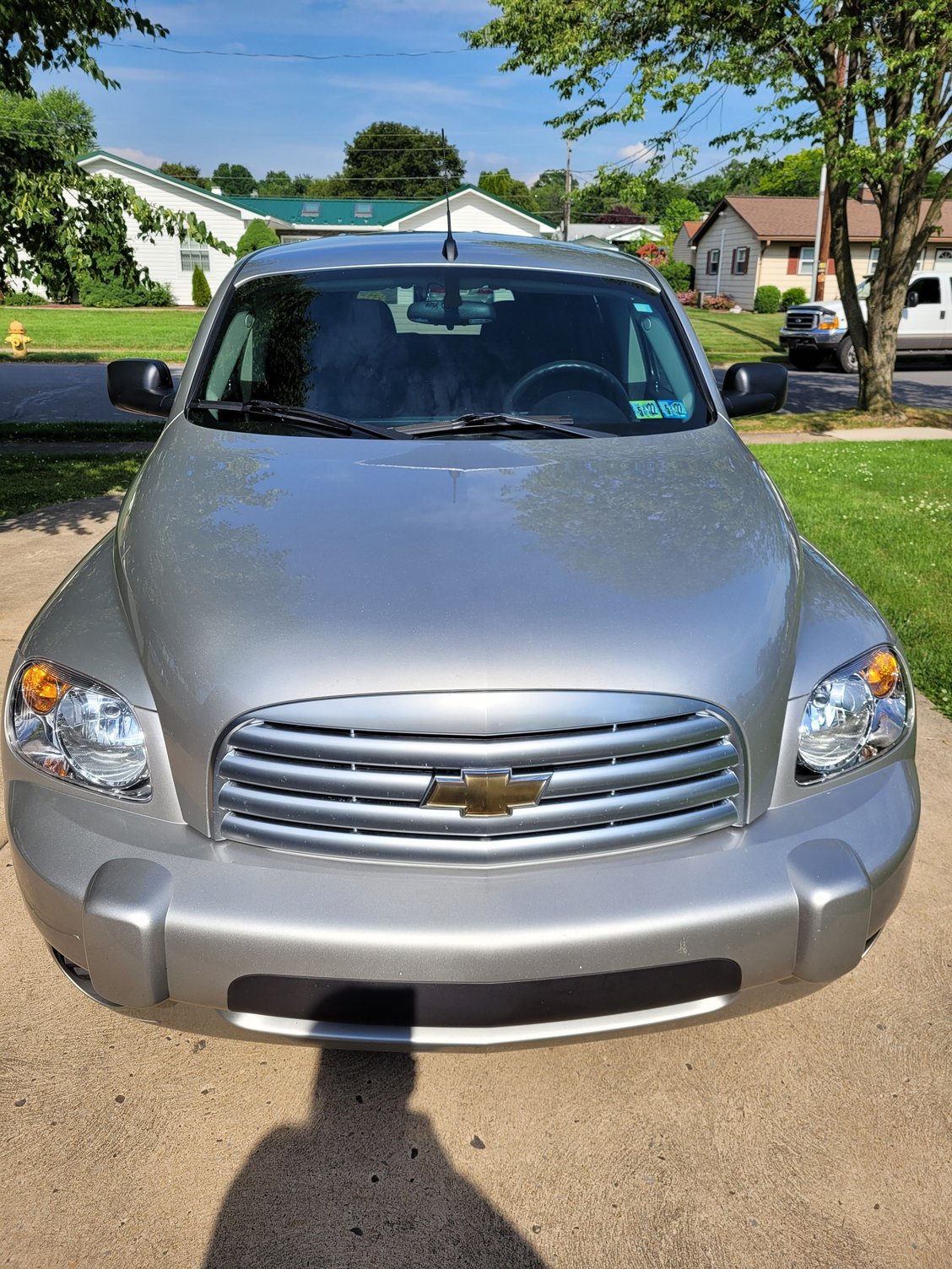

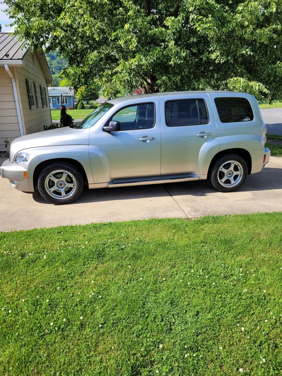

I got a nice note from Michelle, she just had Paddy detailed , she sent photos.
This was 843de’s HHR, she’s keeping it clean at least.
Paddy cleaned up real good! Mike would be proud!
