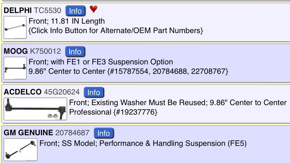

Rock auto, who fortunately provides more info than most suppliers, lists both lengths, whether you select 2.2, 2.4, or 2.0. Some listing give the length, some the FE option, some both, and they aren’t consistent.
Maybe the length depended on the various sway bar designs. Does anyone know for sure if every one of them is the exact same shape? I think if you know you’re replacing the original, just measure it, and if not, call a dealer with the VIN and get the p/n.

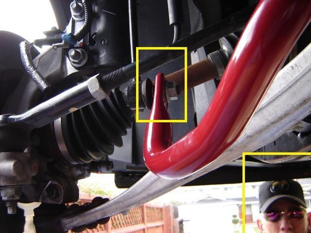

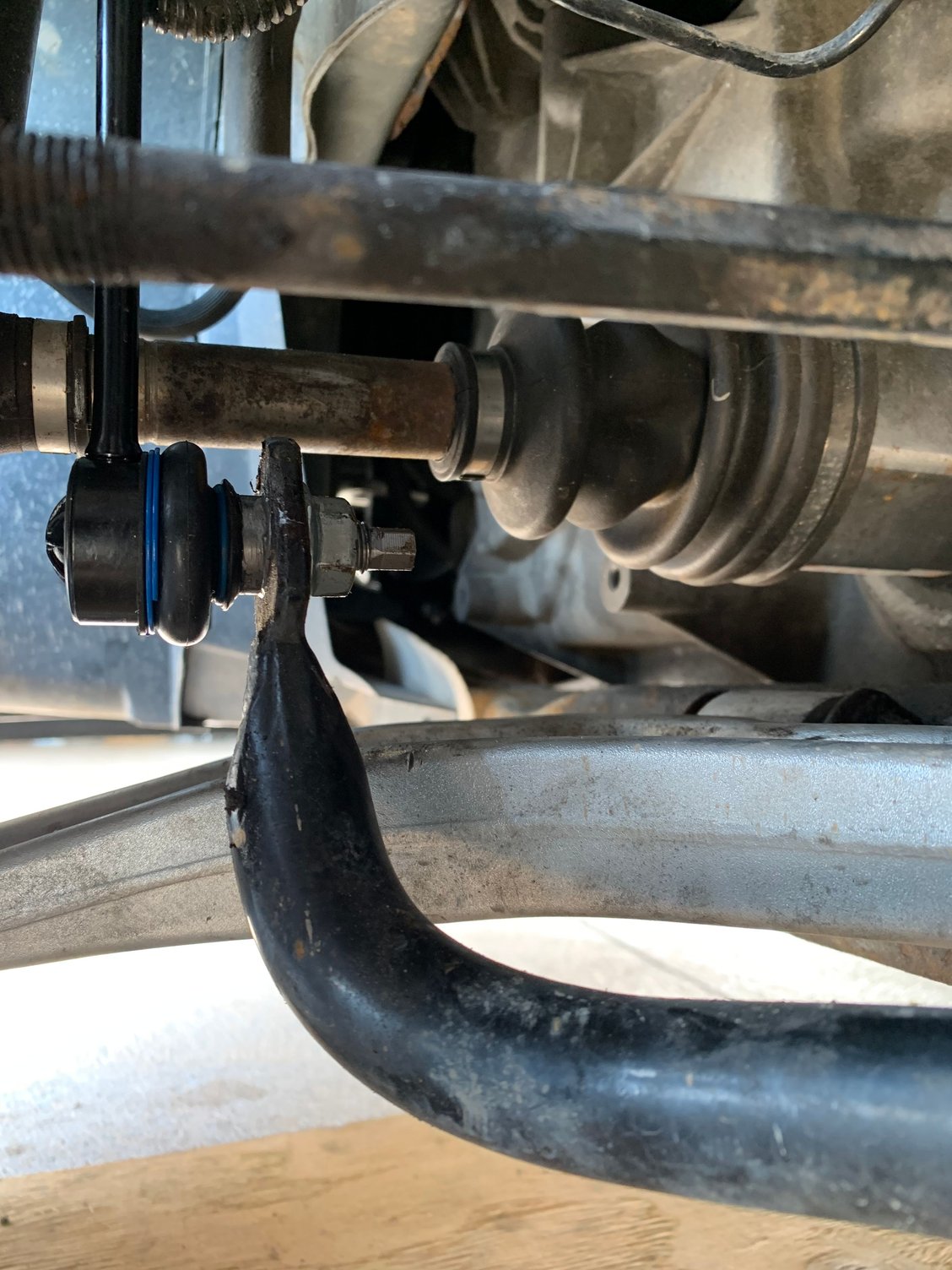

The SS FE5 23 mm swaybar seems to curl up at the outboard ends more then the FE1/FE3 25 mm swaybar
My FE3 bar
An SS FE5swaybar
So that might account for the shorter link fitting the SS and the longer link fits the FE1 and FE3

I just looked up on their website and they list both lengths no detail fitment
Moog K80252 for $63.99.....11-7/8" or 300mm
Moog K750012 for $46.99.....9-7/8" or 250.5mm
