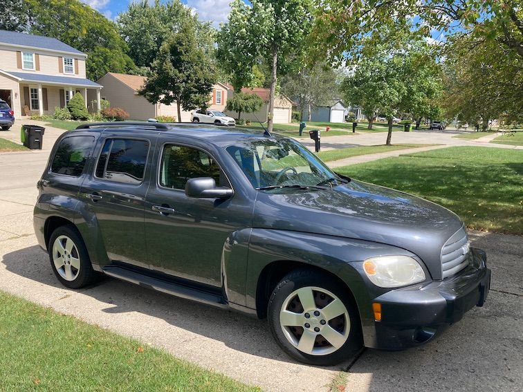

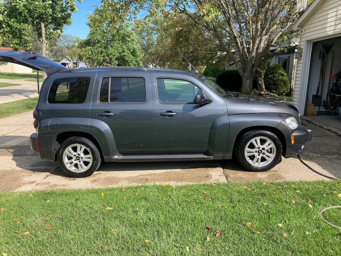

Cheap Guy's Avatar
Joined: 09-07-2021
Posts: 302
From: Michigan
Bunch of stuff...
Okay, here goes…
1. Put LED interior lights in. Very nice, simple upgrade. Also did LED corners, license plate lights and reverse lights. I found anything more than that requires stuff like resistors or other stuff I don’t want to do.
2. Added Amazon cargo net. No more milk sliding around back there.
3. Added overlays to front and rear bowties. Think I’ll probably paint them because the overlays look kind of sketchy as far as sticking for a long time.
4. Added Amazon stainless steel exhaust tip. They sent the wrong one, wanted round but got oval, but I didn’t want to send it back. It actually looks better than I expected.
5. Addressed airbag light. Disconnected all connections, sprayed with electronics cleaner and dielectric grease. Light is out.
6. And finally, swapped out the steelies for Saab wheels I got for $100. The center caps are stickers from Amazon and just stuck over the Saab caps. The black lugs came from a great deal with a forum member. This wasn’t the route I wanted to go – I was going to go with the old school look with chrome full moons and chrome trim on mirrors and other places but I couldn’t pass up this deal, plus I saw myself putting a little too much $$$$ in what’s supposed to be my hauling car.

I think the Saab wheels look good on yer ride.

Cheap Guy's Avatar
Joined: 09-07-2021
Posts: 302
From: Michigan
Thanks. They’re ok, especially for the price, but I had planned on going with an old school chrome look with chrome full moons. I like (inexpensively) personalizing my vehicles so I guess I’ll go with a black trim theme instead.
Old Sep 24, 2021 | 10:08 PM
  #19859
That will be sweet with the body color.
