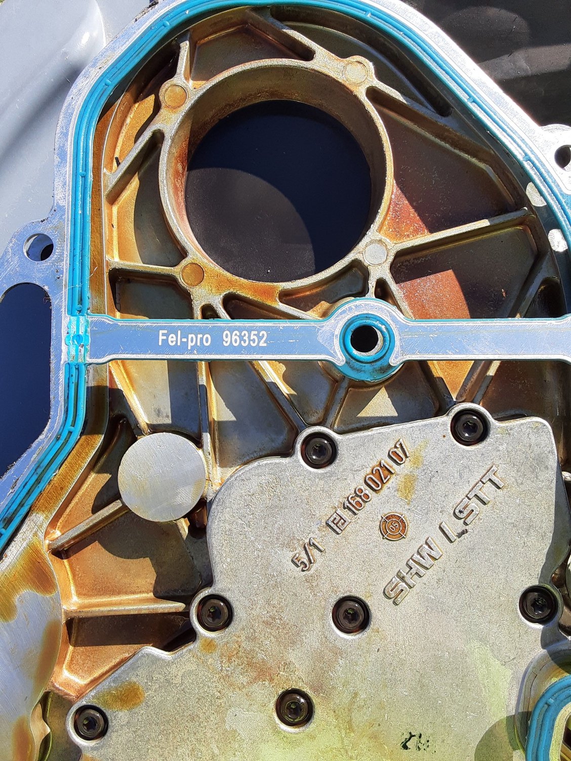

Found the issue and

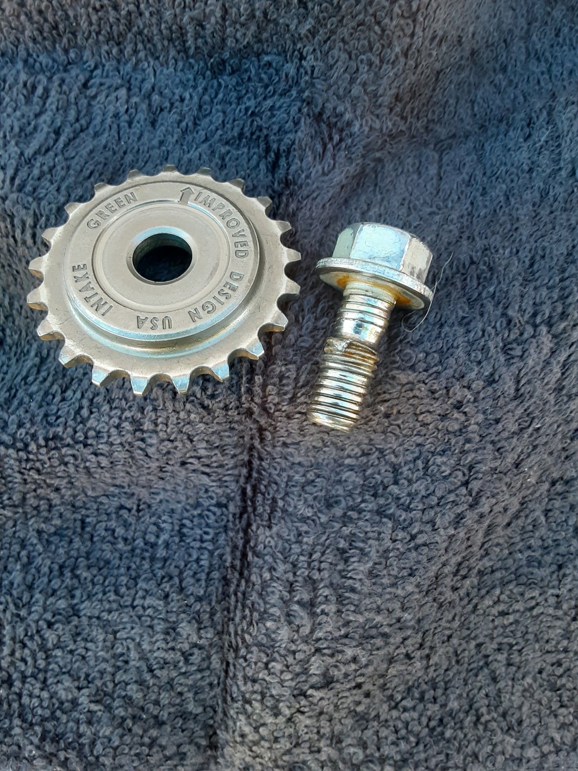

I think the bolt was loose
Bitten by the Felpro OOPSIE

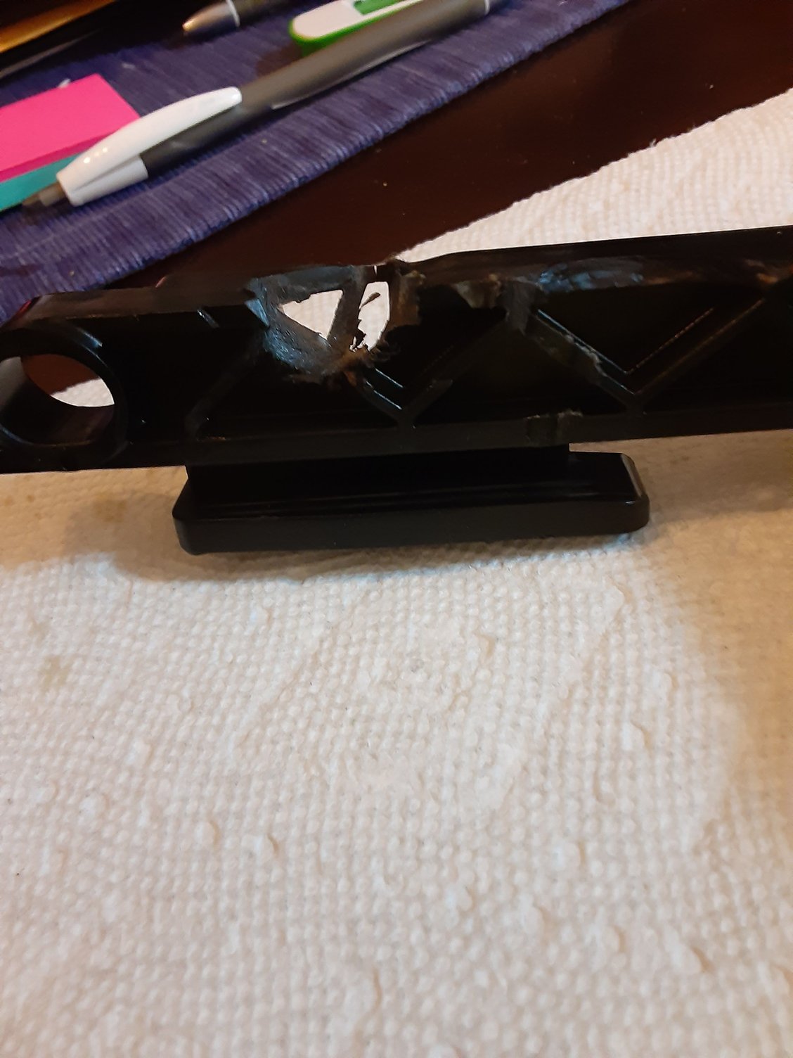

This was holding the bolt in and gear on the shaft until........
Too close for comfort

So the intake balance shaft bolt wasn’t tight, that took out the timing chain front guide.
many other damage from the loose bolt? Is the exhaust shaft bolt Tight?

I foung the timing chain guide damage when I removed it the get the bolt and gear out.
No other damage found AND I will recheck all torques upon reassembly.

Yeah, and those shards from the front guide are a little plastic wrenches in the works.

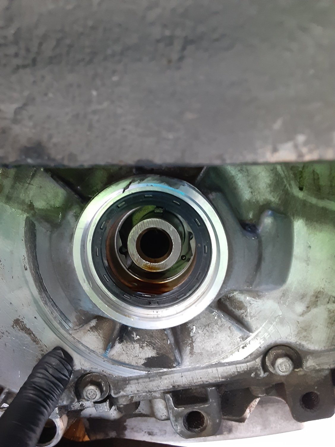

Did you know that the balance shafts cannot be removed while the engine is in the car?
Due to the loosened gear rattling around, the shaft end got a little beat up.
Looks like I get to hand finish the parts so that the gear can be reinstalled, AND TORQUED.
