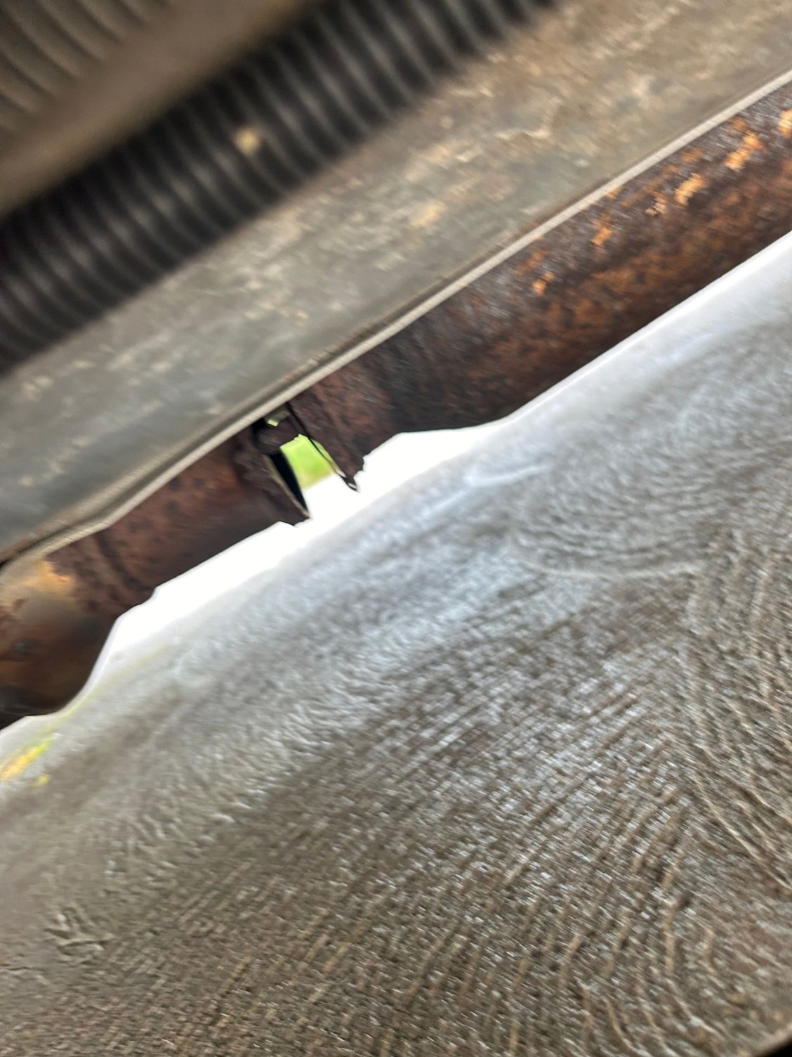

Drove out to Smithville to the Timmies a visit with the_shmoo. On the way my exhaust sounded really loud about half way there, the two studs at the flange just behind the catalytic converter pipe had rusted away, so when I got home , I jacked up the driver side put it on a jack stand, supported the catalytic converter and drove the studs out, thankfully the gasket is still good, I had bought some 3/8 bolts they fit and tightened up nice . A turn of the ignition key confirmed problem solved It’s quiet like brand new!!

Kids and their hot rods! At least it wasn’t ricey!! lol.
The opening at the flanges with rusted off fasteners.

Yep, that would do it. LOL
