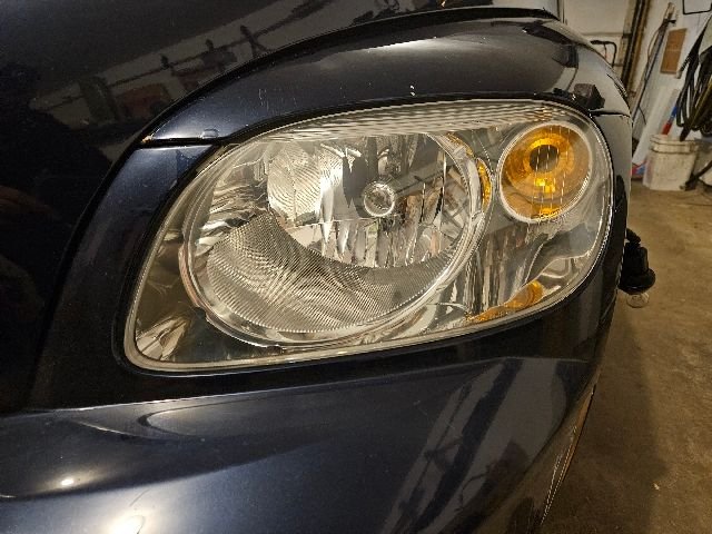

Restored the headlights with Cerakote Ceramic Headlight Restoration Kit. Not bad for under $20 and about an hour of work. Hopefully it will last.

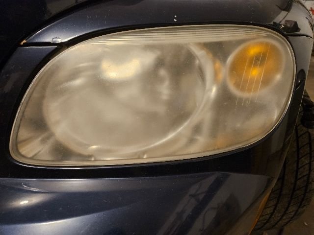

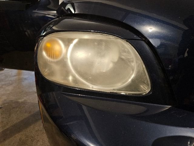

This is what they looked like when I started. The guy I got this from said that he did the toothpaste thing about a year ago.

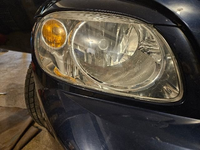

And the finale results.
The passenger side has a couple of waves in it (that is my fault, trying going over it again.)

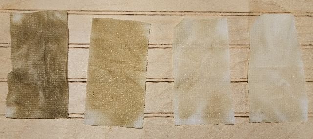

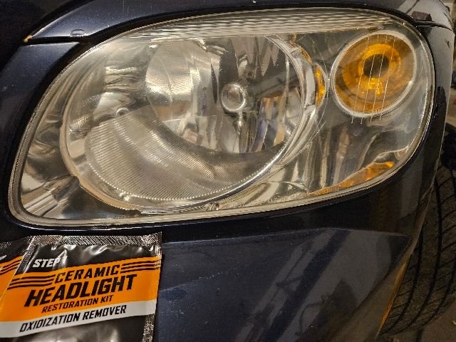

I did it completely with elbow grease. LOL This kit uses chemical to remove some of the oxidation and then use 2k and 3k sanding pads to prep the surface for there ceramic coating.
This is after the first pad of 4, in the picture below it is the really dirty one on the left.
