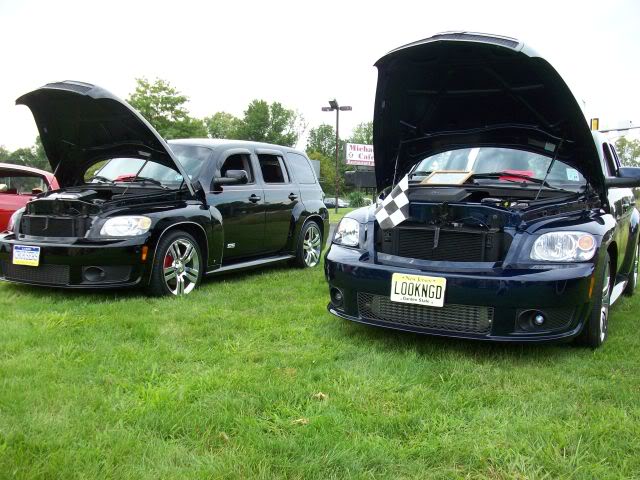

Went to a Cruise Night with Scott (Chevypimp65) at Hooters in Bensalem PA.
