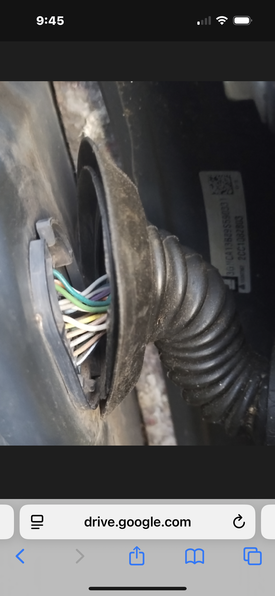

In reporting a fllooded passenger floor, some of you suggested I check the wiring harness boot on the open passenger door to see if the boot had pulled loose. Sure enough, it was pulled away. I'm not finding a lot online about how to get it reattached. The only thing I did find was on Reddit, saying the ring attached to the car has to be removed and replaced in the inside boot channel then reattached. Problem is, upon inspecting the inside boot channel, it is really sloppy and I am not sure that ring would remain within it.
Anyone deal with this? Picture link below.

Reattaching it is a matter of squeezing it to fit the groove into the hole.
