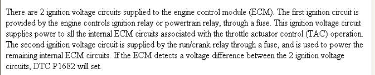

Posts: 26,532
The crank sensor isn't going to harm the engine, mostly your mpg.
The P1682 is what won't let it start. That power for the poertrain and run/crank relays.
