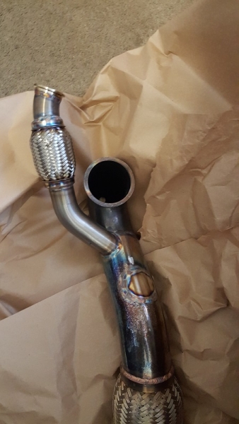

Well, it's certainly been a while. I have a lot to report. First of all, the downpipe got sent back and returned completely different! It actually fits the car now.
The reason for the winter surgery was simple, correct the pcv system. Project overboard was indeed a perfect fit for this car. Nothing is simple once you've gone this far. Since I had the intake off, might as well powder coat it.. Since I had the valve cover off, might as well powder coat that too. So on and so forth, that's how it went. Then every bracket needed coated...sheesh, why did ever start that mess! We had the VC and intake off so it was a perfect time to install the Opel fuel injectors and upgraded fuel lobe cam. I also snagged that wideband gauge during the Black Friday sale. Whew, on with some pics!
This is what an auto DP looks like! Why we didn't get this the first two times I have no idea. It fits like a glove now.

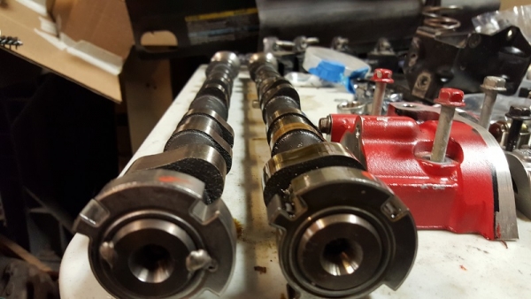

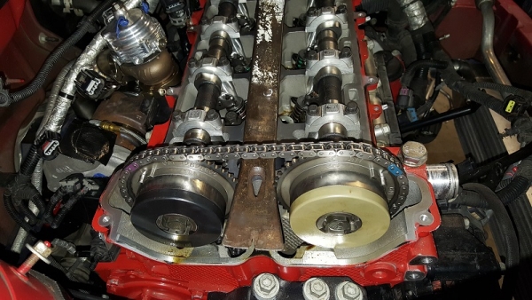

Here's the super expensive LNF cam holding tool. An old flat pry bar.
New intake cam on the left. You can see the raised fuel lobe cam, no changes to the valve cams. Just allows me to shove more fuel for a longer period.

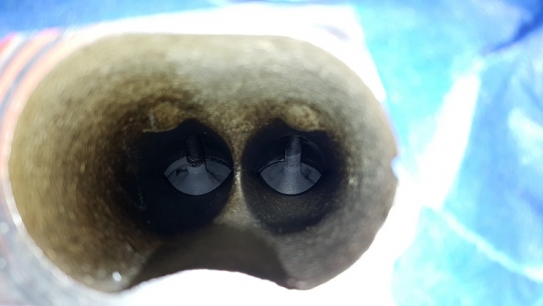

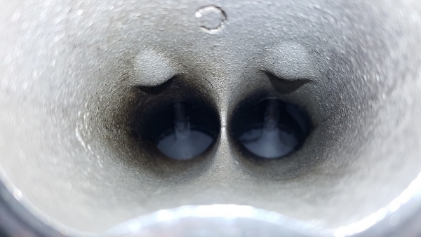

I was fully prepared to walnut blast. When it came time, I decided on simply scrubbing the intake ports. Got all the crud out really easily since it was only a few thousand miles worth.
BEFORE
AFTER

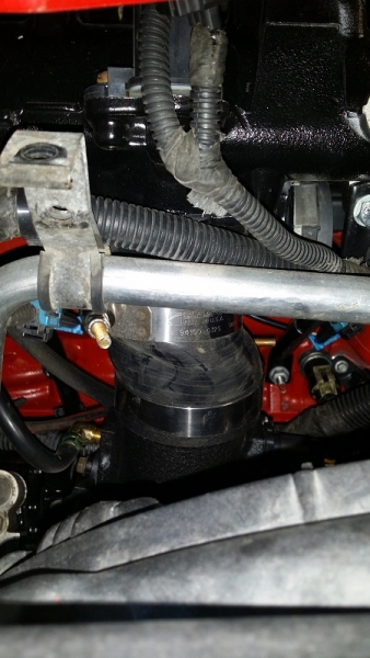

Here you can see how twisted my Lower Charge connection was, those clamps should be parallel... no wonder it kept blowing apart at the intercooler. Jammed and twisted

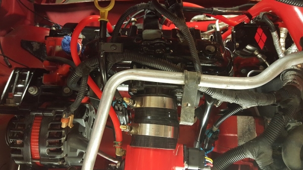

Here is the same connection today. Highly modified, both the pipe and the silicon couplers.
Couple changes made under the hood as well. Added about 2' of the wiring harness to extend the boost control solenoid. It is now mounted next to the turbo bypass valve on the intake. That alone shortened up the vacuum routing considerably. If you look close you'll see the temporary "mini" catch cans I made from two halves of the real thing. These are temporary, we just wanted to get the car running. Just a sintered filter and chore boy inside. All will be completed using -6AN lines, in a week or two when I finish a couple full size cans.
