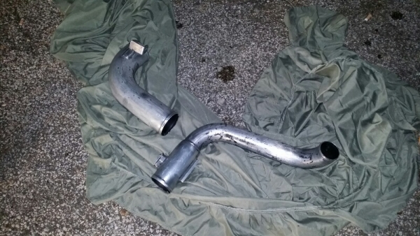

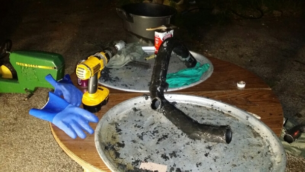

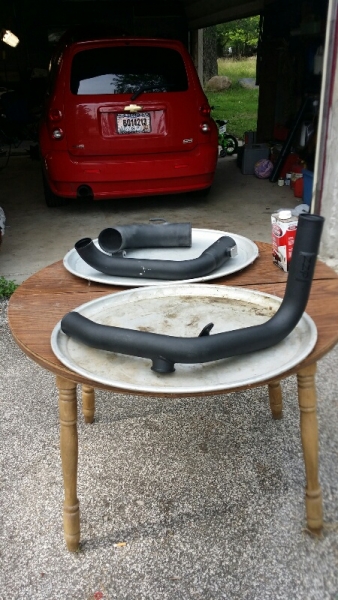

First up, pulled all the charge piping and intake tube. Tried sandblasting for about 15 minutes. Still couldn't get to bare metal! ZZP has some good powdercoating. I ended up using Aircraft Stripper, A LOT! Probably took 6 hours to get most of it off. Dropped off the pipes today so hopefully we'll have em back by the end of the week.

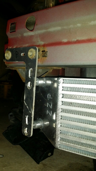

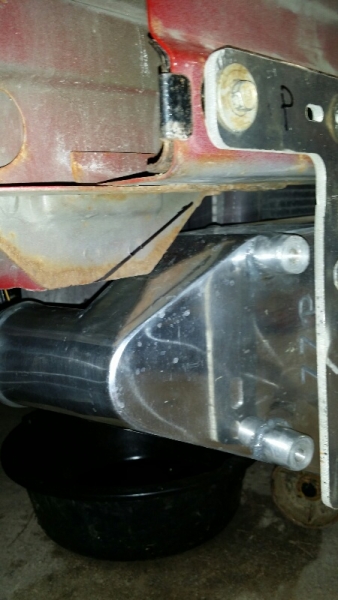

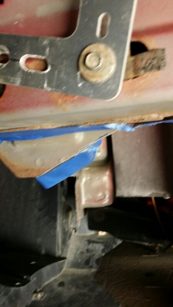

My ZZP IC brackets needed to be modified to allow me to raise it 1". Drilled in some slotted holes. Raising the IC that much caused clearance issues with the bumper frame. Did some handiwork with 4" grinder and welded the pieces back together. Haven't fit it yet, waiting for the POR 15 to cure.
Just needed a bit more room here...(both sides)
Here's what's left.

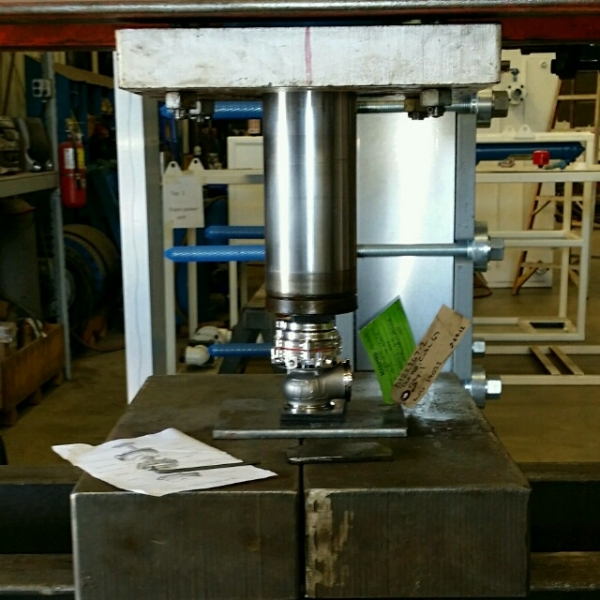

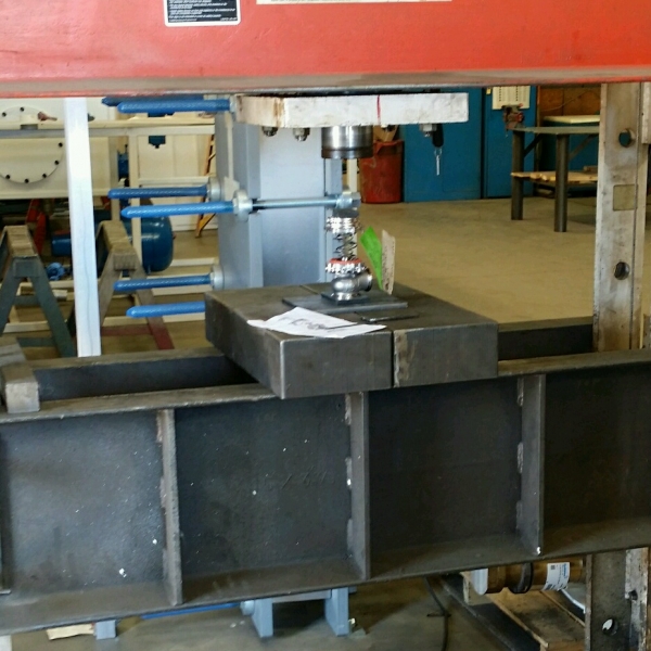

I've been easy on the new motor and turbo. Got about 700 miles on it now. Time to have some fun. I wanted to increase my wastegate spring pressure. When I removed the wastegate I found I had really been taking it easy, I only had the 8lb spring in there! I tried installing the new springs (now it's 3 instead of 1!) But couldn't get it even without trying to blow the M4 screws off. Luckily I have a 100 ton press at work and that made things MUCH easier. Now we're set to 23.6lbs on the wastegate relief.
