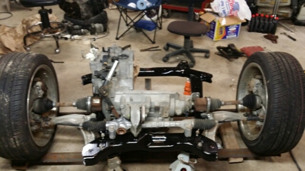

What are using the POR-15 for?

While it wasn't really rusty. I couldn't help but do the sub frame with POR-15. It looks good and keeps that nasty rust away!

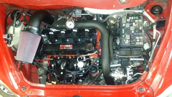

Talking Contact!
Got the Gen 3 with Bullseye 256ET in its new home. The larger turbo is a tight squeeze over the auto trans, definitely glad I did most of the install with the cradle out.
Looks good but I think I'll switch the valve cover to red. All that's left is bleed the brakes, hook up steering, and add all fluids.
