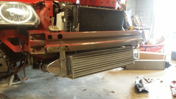

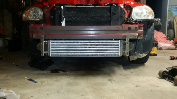

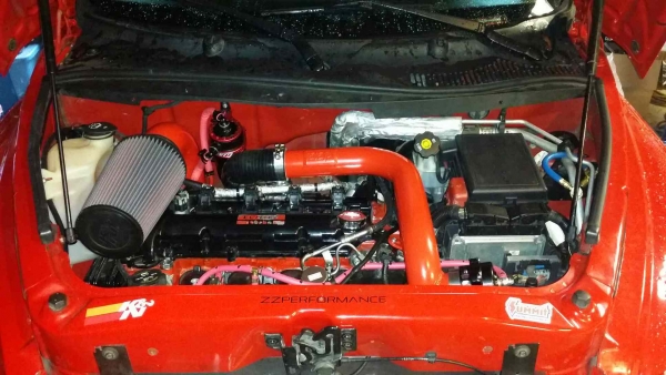

So I'll add to that. On top of reinstalling the charge piping, there's s bunch of stuff we took care of.
1: Intercooler officially fits inside the bumper. Had to make new mounting holes and chop about an inch from the bumper frame.
BEFORE
AFTER
2: Installed Mishimoto Baffled Oil Catch Can. The fittings it comes with were too large M20 X 5/8 hose. Our PCV lines are 3/8, no bueno. I found M20 X 1/2"NPT reducer bushings (at work of all places, not an easy thing to come by!). Then we did a home depot run for the 1/2 NPT X 90* 3/8 barb. All plumbed and catching oil (in theory!). This will create many questions so I'm currently working on a how to for catch cans.
3: Increased wastegate spring pressure. With nearly 700 miles on the new engine/turbo I figured it was well broken in and time to start playing. I had only the 8 lb spring installed initially. Now we're set to 23.6 lbs!

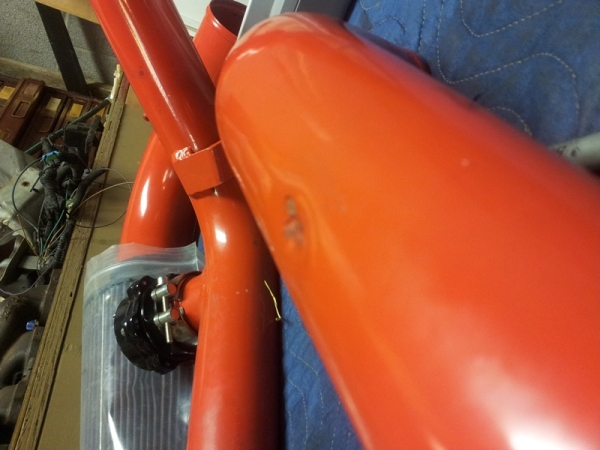

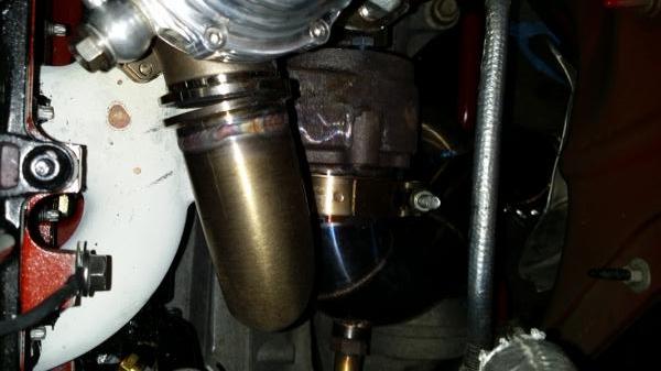

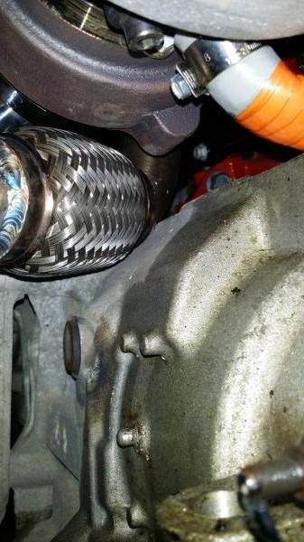

Problem #1: Downpipe re-circulation pipe was jammed against my transmission. Every time the car shifts or hits a bump the clanging would start. I didn't feel like practicing my TIG welds so I sent that back to ZZP for reworking. I had asked for a Wideband Gauge for my troubles but they were only willing to give me a $60 dollar discount. Which, don't get me wrong that's a discount. But I've got at least 20 extra hours of rework making everything fit. They did however install a 3rd O2 bung..which now I'll need to plug. This is puzzling because apparently the SS already has wideband?! I would've thought they would have informed me that this extra hole is unnecessary. Alas, I'll plug it and piggyback off the ECM for Wideband Tuning. The recirc pipe was so tight against the trans that it was a SERIOUS struggle to get the wastegate flange together. It ultimately leaked anyway..
As you can see the flex is useless because it's before the jam. What I had them do was concave the spot that's hitting the trans. Should give me an extra inch at least. The other pic is of the wastegate flange. That was as close as it would get. I had to use longer bolts just to get the V-Band clamp to close!

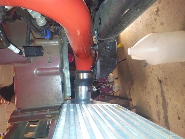

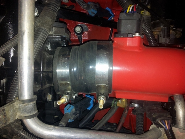

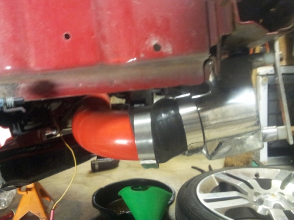

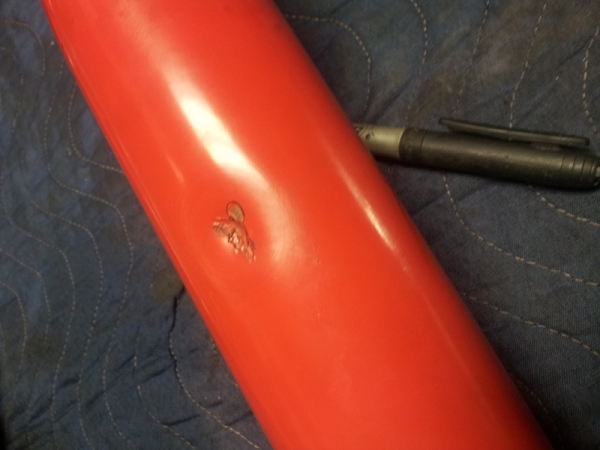

Problem #2: The Lower Charge pipe has always been a thorn in my side. I didn't realize how bad it was until I pulled everything apart. The connection between the LC and intercooler would blow apart under heavy load. This is where the manual trans comes into place. Apparently the engine sits at a slightly different angle than the automatic. I tried everything to make it align properly. ZZP's solution is to cut 6" off the 90 on the IC side. They sent me a long silicon 90* to replace it with. This is not really acceptable in my eyes. I've seen complete turbo systems made from nothing but silicon tubing, it's just not as effective or clean in my eyes. The other issue I didn't realize I was having is that it hits the mounting bolts for the AC compressor. While I'd love to do an AC delete, I don't think the wife will go for it! I'm afraid if I used the silicon I'd put a whole in it.
See the awkward angle its forced into the IC.
I can't get these to rotate no matter how hard I try...sorry!
Here's the dent from the AC mounting bolt, not nice!
