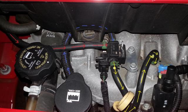

Originally Posted by raccoonjoe
Idle is rougher with MAF unplugged. I went back over the intake system, thinking I may have missed something. Found the waste gate controller had a broken vac line. New one is on order, update to follow tomorrow
Yeah, depending on which vacuum line was broken, it could run poorly.
Out of curiosity, which line was it ?
Name:  Bypass valve vacuum hoses.jpg
