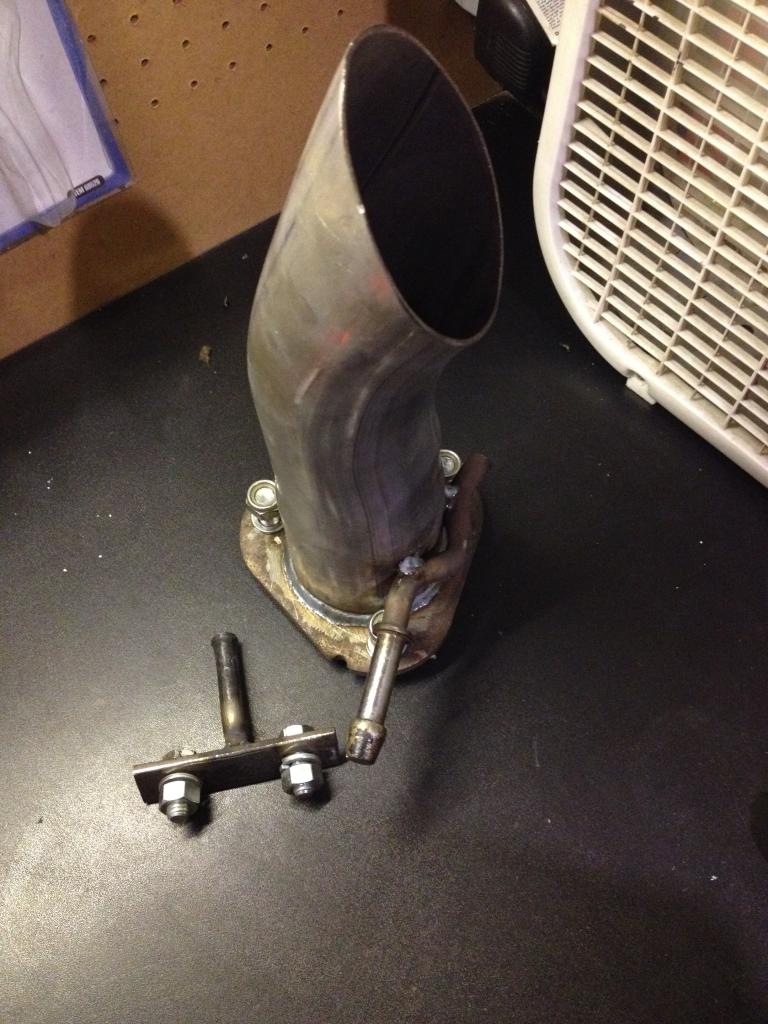

I've always wondered what the car would sound like with a dump tube bolted up to my catted DP so I want ahead and fabbed up a 3" dump pipe. It was a legit fab with hangers and all. Here is what it looked like
The very next day I took it off because it was the worst sounding car I've ever heard and it was so effin annoying. What was I thinking you ask? Like Dave, I too am not afraid to try new things to see what advantages are available, even if it is a small advantage. Nonetheless, if the hp gain would outweigh the tq loss i still wouldn't even use this for track days only. Part of the reason I did this was to see how a 3"cutout would sound and affect power. But I think even a deaf person would hate this setup lol.
Dave, now i have to STRONGLY disagree with your statement about our buggys not sounding good with some more open exhaust persuasion. After I re-installed my catback I did the muffler delete mod and I must say it sounds AMAZING with a catted DP. I too do not like the sound of most four bangers with exhaust but ours is special and carries a unique tone. I like a mellow exhaust note and this provides just that. IMO it makes the car sound quite impressive, not obnoxious or loud. But it's hardly "stealth"
