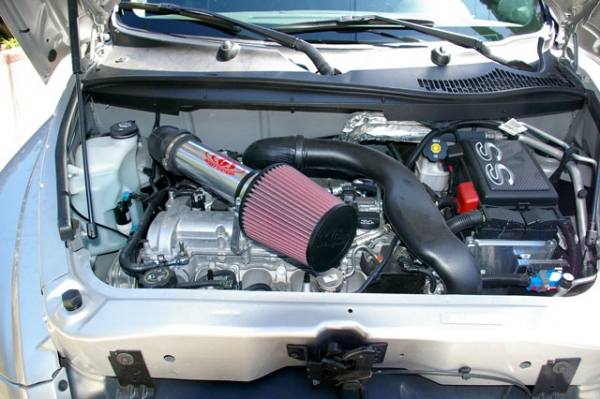

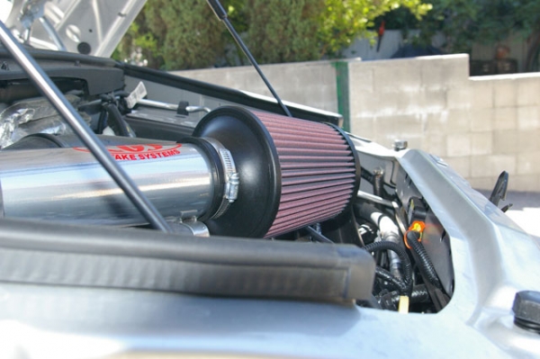

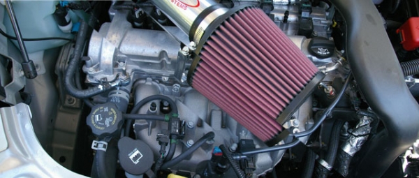

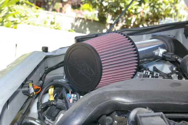

I will get some taken tomorrow.
thanks for the pics, it seems like it needs that plate (from the GMPP setup)around the bottom to help reflect the engine heat away from the filter. it will be interesting to see if there is any gain at all in HP &TQ with this unit. only time will tell. BTW, good pics

Dyno claims 11 wheel hp
But remember, that's with the hood up. I know, I know, ALL aftermarket intake manufacturers test with the hood up. Yep, that's probably correct. But the auto manufacturers, at least GM, do not. They test in a carefully control chamber, that provides REAL WORLD/USE numbers and the hood is down.
Also remember, the CGS intake is a "heat soak" intake which pulls air from the engine area. Obviously testing with the hood up would provide favorable results, since the heat dispates rapidly in a non-confined environment (think about the HOOD BLANKET that the SS DOES NOT HAVE....wonder why). GM's stock intake pulls intake air from the front grill/fender area. A difference of some 30-60 degrees (3-6 HP). Now think about this......why would GM include the additional cost of the tube (although somewhat minor....but multiply that times 50,000-70,000) to capture the air from the front of the engine compartment vs. from INSIDE the engine compartment?
Here's an idea....
Do a dyno test with the stock intake removed. Put a filter on the end of the MAS tub (to prevent dirt/dust ingestion) and run the dyno with the hood up. Do you suppose you could/would witness a HP increase? You bet....I've seen it done when the first CGS/HHR arguement appeared (If a former member was still participating on this forum, he could validate my statements. I provided him the info).
Realize, I'm NOT indicating you will not recognize SOME power increase with the CGS. But, I seriously doubt that 11 HP is realistic.....more like 2-4. Especially with an intake sucking air from an engine compartment that generates additional heat do to a turbo.
