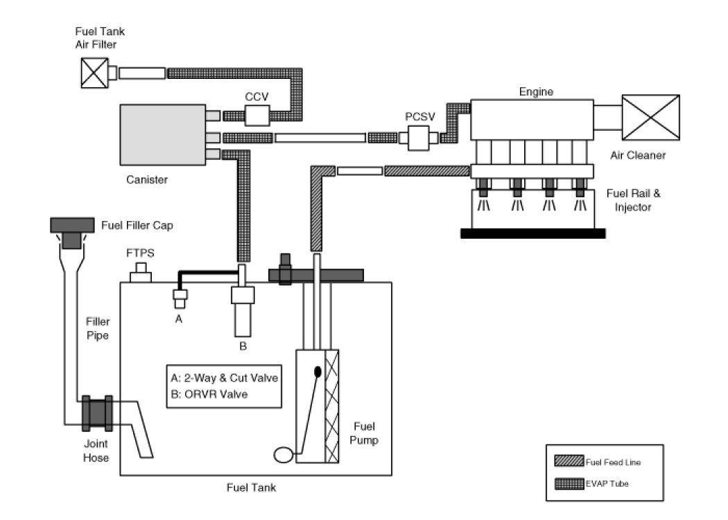

You blow shop air from the purge valve back to the canister.
This is a typical evap system.
