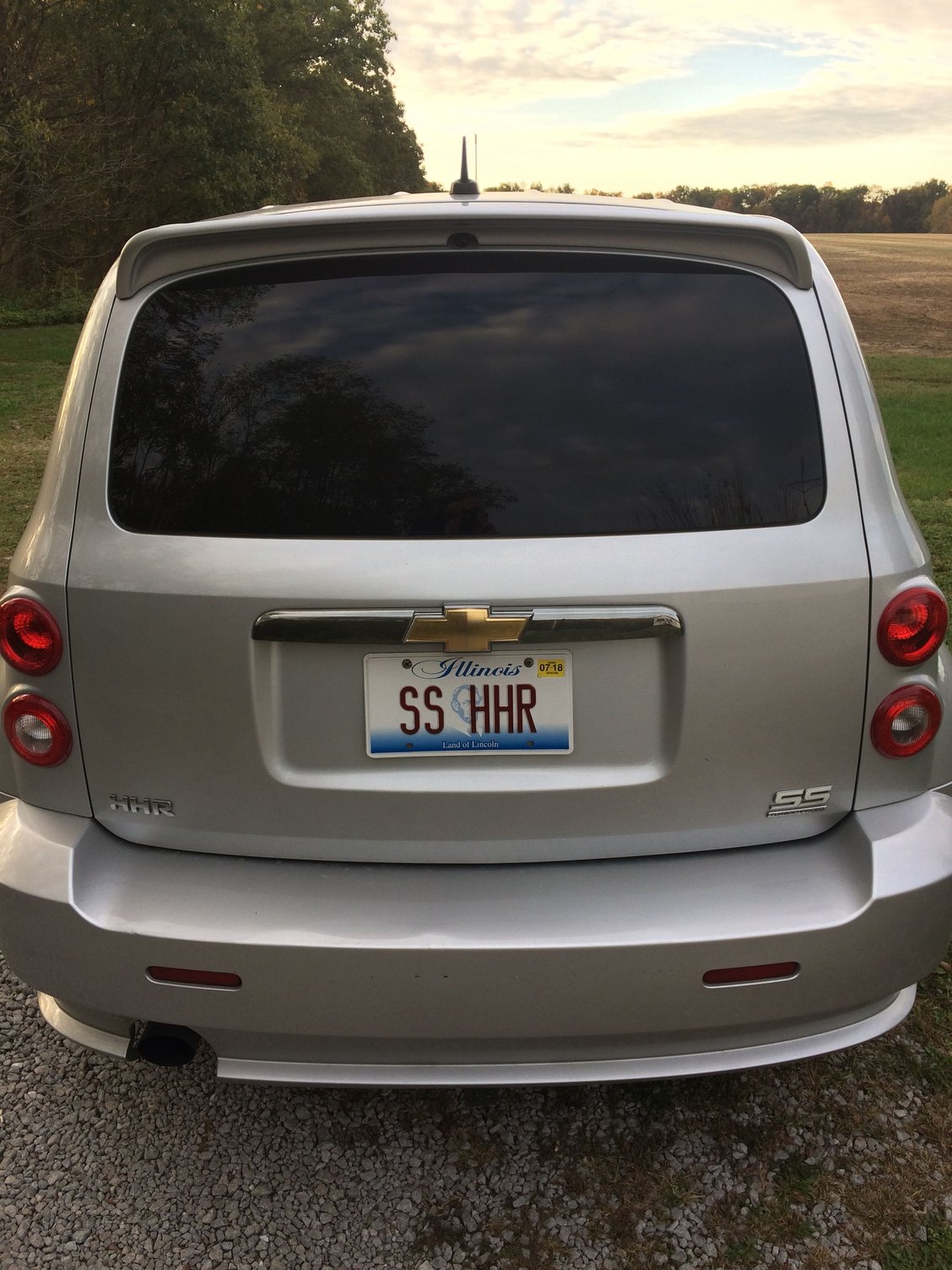

I just noticed we have the same plate!

Cool!
Glad it worked out for you finding that axle. I was doubting that anyone would even admit having a "rare spare". Then finding someone like 2005HHRauto to sell you one, well, didn't think that would happen. Very generous of him.
You might want to get some lottery tickets. You've got some good luck going for you right now.
Hmm. Is that a chrome beauty bar I see ?
