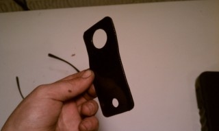

Here is a pic of one of the custom brackets i made.
The OE bracket has a hole in the side to secure those plastic cover things on the underside. Obviously, my bracket doesn't have that so I simple secured that plastic cover by simply running a tap screw through it into the frame rail, easy.

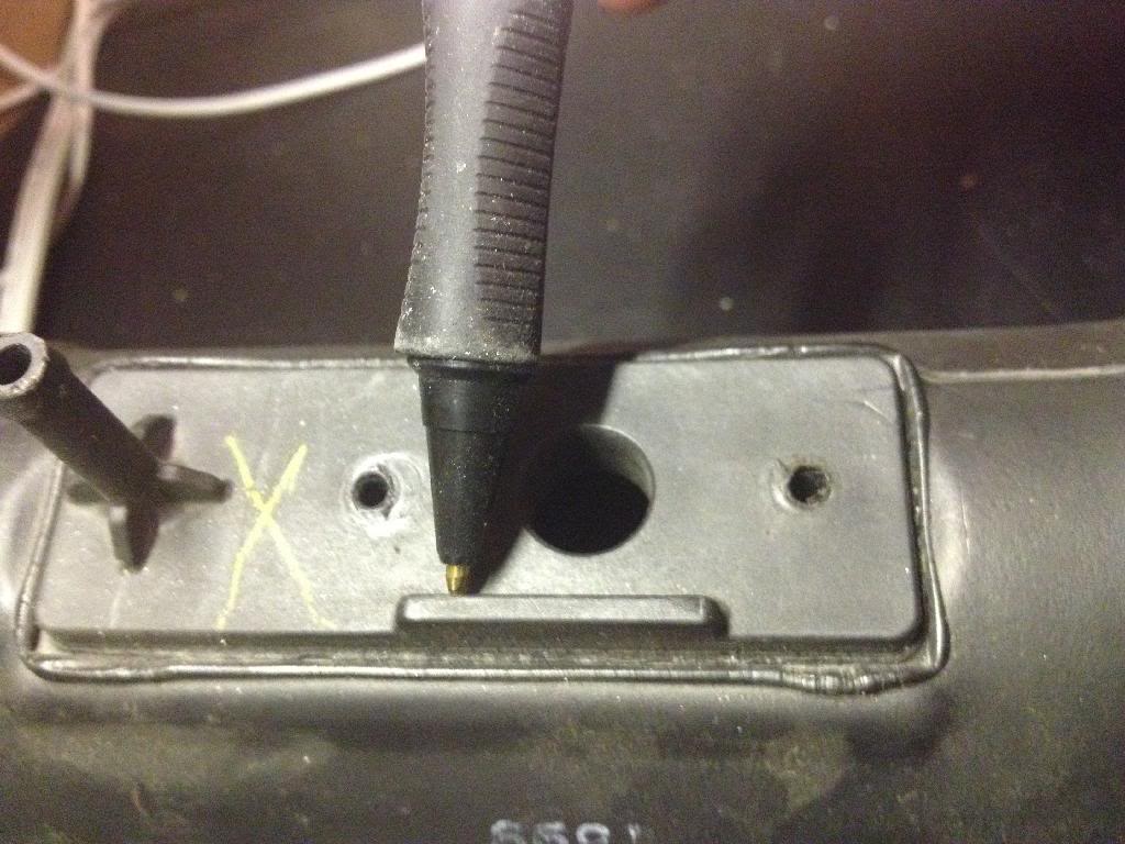

In order to flip the sensor 180 degrees you have to cut/grind off this anti-rotation bar on the lower charge pipe.
