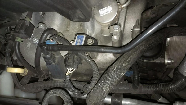

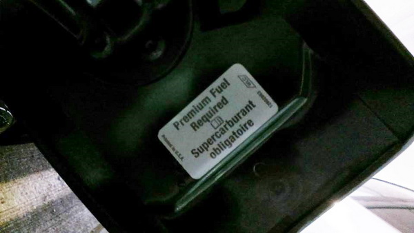

Check to see if it is tuned. The GMTU will have blue sensors on the front of the engine and High test only on the gas fill door and a sticker under the engine hood. Nice ride, mines a black 08. 32,000 miles on it.

The stickers aren't a sure sign(many like me, never put them on)
The blue Bosch Tmap sensors are the thing to look for. One up top and one below on the lower charge pipe, right in front of the AC compressor.
Top sensor:
Attachment 16249

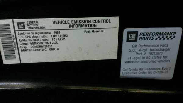

Just snapped a couple pics. So it appears I have the GMTU (stands for GM tuned?) Sorry for being such a n00b but what advantages does this provide over stock? Specs etc... Basically, just trying to find out what this car has in it and if it has been configured correctly etc...
Old May 21, 2014 | 12:26 PM
Posts: 11,721
GMTU. GM Turbo Upgrade. Also referred to as the Stage 1.
Stock SS is 260 hp, 260 ft. lbs.torque in 5 speed. Stock autos are detuned to something like 235 hp in the 1st (and 2nd ?) gears.
The GMTU will up the 5 speed values to 290 hp, 315 torque for the HHR SS.
An increase of 30 hp, 55 torque.
Thanks fireman... so it appears I have the GMTU then based on my pics?

My '09 SS auto has the "premium gasoline recommended" sticker on the gas cap door but doesn't have any blue stickers on the engine. Is this gas sticker standard with the SS model?
