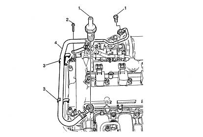

Number 2 in the picture is a coolant return pipe for the turbo. Don't know what a bypass hose would be.

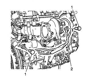

Number 3 is the feed pipe.

Thats where it was leaking. Thanks
