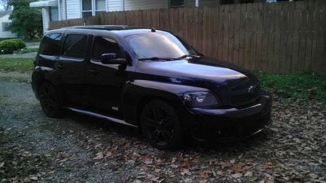

Hey guys,
I've been slowly doing a build on my 08 SS.
I'm keeping thing simple and mild as far as exterior aesthetics and added HP/ Performance.
I would like to add a bit HP and make the exhaust and turbo sound nice.
So what should I do for a few mild HP add ons?
I was thinking this.
Cat Back Exhaust
Downpipe
BOV
Cold Air intake
Tune with added Boost
I can't seem to find many options on the intake or BOV though.
Any brand preferences on which of the items listed works best and can be had at a nice price?
