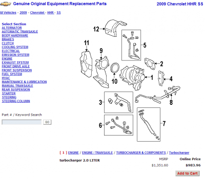

My 2009 Chevy HHR SS with 106,000 miles has a blown turbocharger.
$500 for labor. GM wants $1,300 for a new turbo. The shop says I can get my own and they will install.
I can get an OEM one for $900 from buyautoparts.com
2009 Chevrolet HHR Turbocharger Turbocharged Models 40-30171 AN
Has anyone dealt with buyautoparts?
Thanks.
