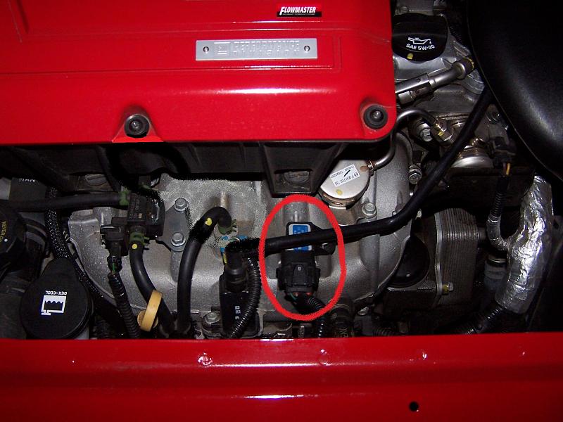

Well. Post #1 says you have the GM upgrade. Post #10 says the dealer replaced a map sensor.
You might want to double check that they replaced it with the correct sensor.
The upgrade or GMTU as we call, involves replacing the 2 Tmap sensors to Bosch ones. They can be identified by the blue sticker on them.
They would look like the top one pictured below. There is also another one on the lower charge pipe about 3 inches from the AC compressor.

The top one is correct. I'll have to check the lower. I don't know which one they supposedly changed. Would the map sensor cause both codes? Is there a way of knowing which one is bad?

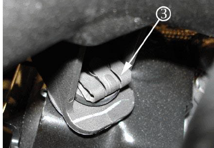

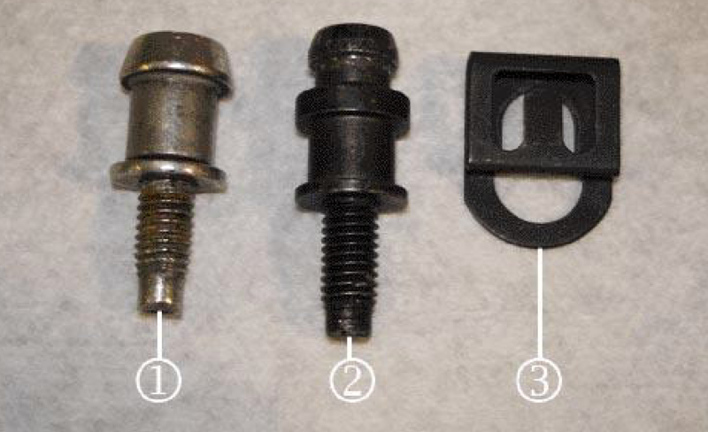

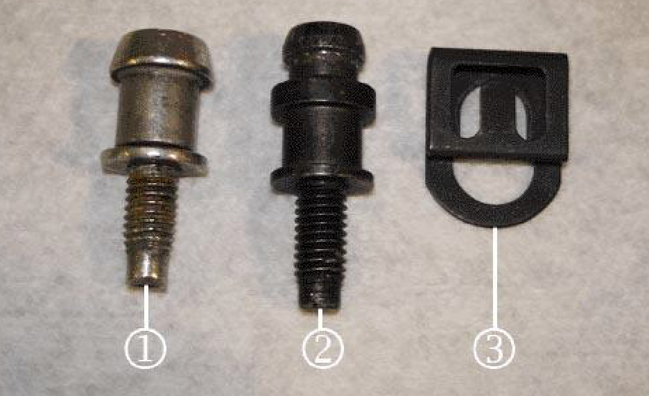

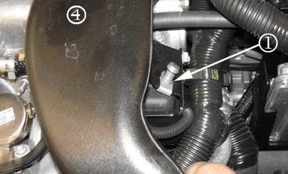

If you have something that looks like #1 in this pic you need to get an updated part. This lets the charge pipe hit the high pressure fuel pump wires. Service Campaign Bulletin #09126 for 2008-2009 HHR SS equipped with a Manual Transmission.
It should look like #3 in the second pic.

#1 is wrong combo of #2 & #3 is correct
