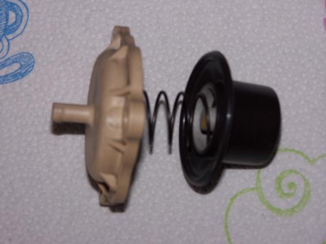

I will probably solder the wires this weekend just to rule it out but I really don't think they are the issue. After searching this and the cobalt site I'm thinking maybe the bypass valve could be an issue. Any thoughts?

Possible. If you wanted to pull it and take a look at the diaphram, it's just three small 10 mm bolts and the vacuum hose to remove. Problem is access. Kind of tight back there. I pulled my stock valve and replaced it with a Forge unit years ago.
Here's what my still good stock unit looks like.
