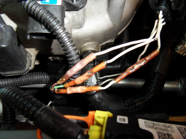

No Boost Problems for 1000 miles!
My HHR with the GMTU was falling flat on its face with zero boost almost everyday a while back. I completely lost my trust in the car to get me to work and back home everyday. I had been so focused on the known lower MAP sensor issues (crimp connectors and hitting A/C compressor) that I forgot to check the upper MAP sensor wiring. When I did, I found these crimp connectors (with TWO nasty connectors on what happened to be the 5V source wire). I cut out the connectors, soldered and shrink wrapped the wires, and haven't had a boost problem for 1000 miles! I FINALLY have my confidence in the car once again...knock on wood.
