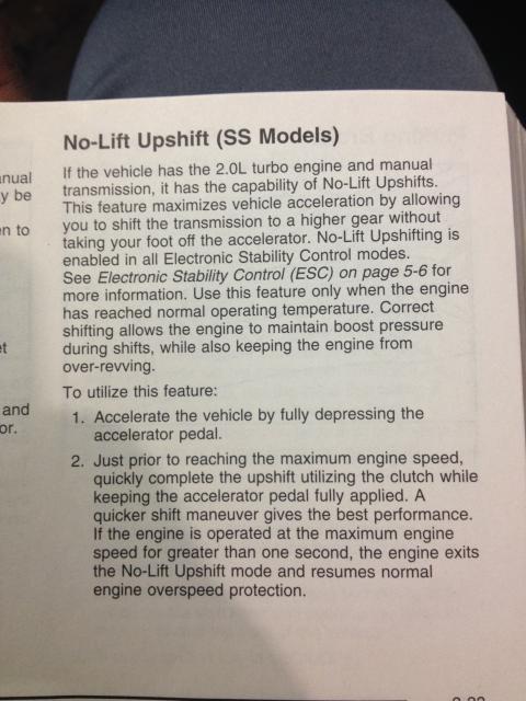

Actually you don't have to turn on comp mode. It's active in all modes. Here's more detailed info:

OK, thanks for the correction, I even saw a gm video saying different.
