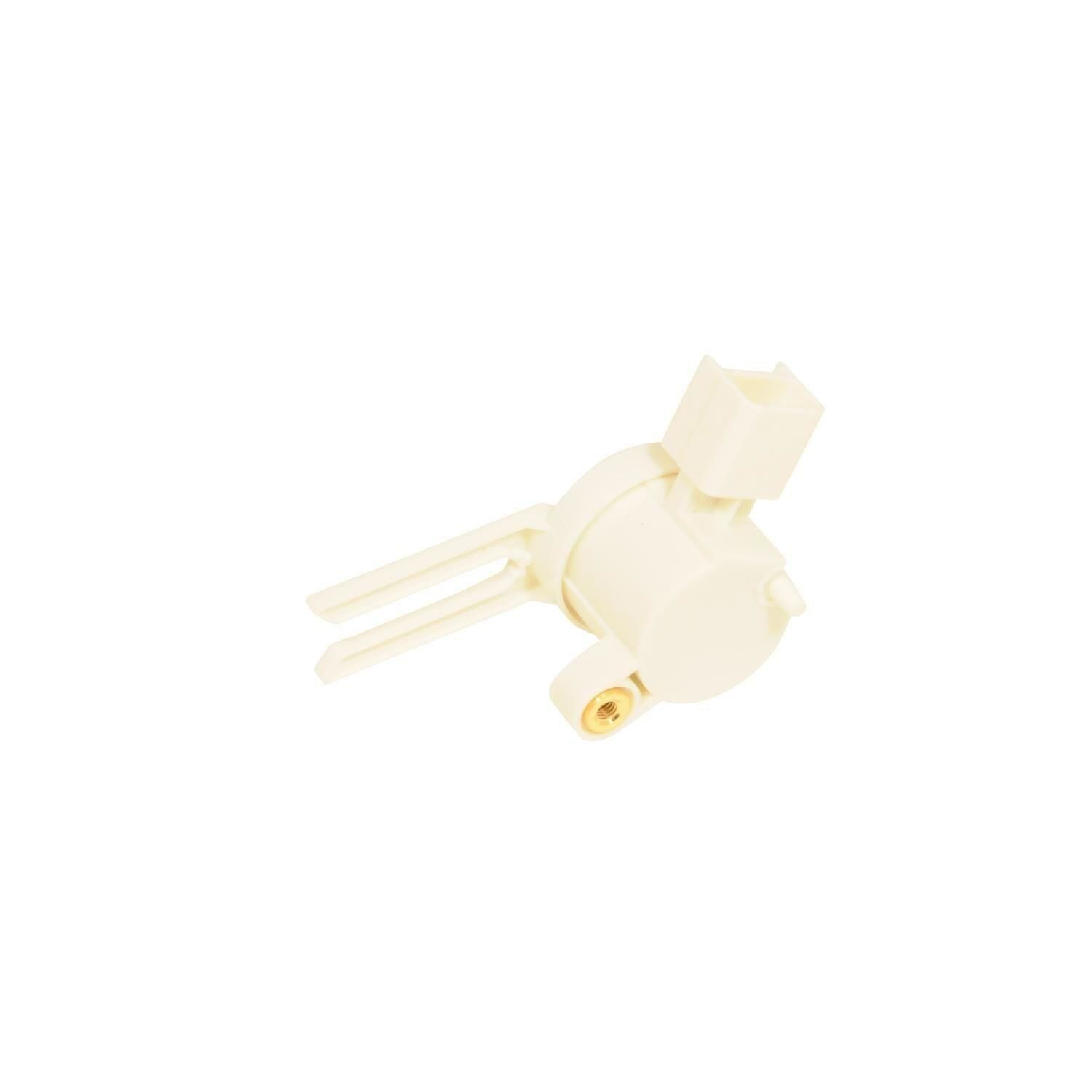

Before anyone starts in about a clutch position sensor vs a break sensor, I am going to attach a couple pictures. The reader code says clutch position sensor. When you put in a search for a clutch position sensor it comes up as a break pedal sensor. But if you click on the brake pedal sensor it will suddenly take you to the clutch position sensor.

The clutch pedal position sensor and the brake pedal position sensor is the same part number. I swapped them once, long ago, trying to fix an issue with the throttle hanging for several seconds after the clutch was depressed and the accelerator pedal released. I never had the issue again.
